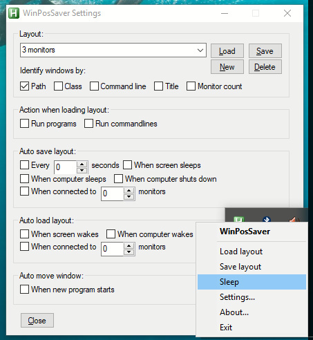

I've started adding a few options, check out the settings screenshot. I hope to have a working version soon.
« Last Edit: July 28, 2017, 01:52 AM by skrommel »
Nice -- looks like this could become a mutlti-faceted tool..
More importantly though: Second night of real-world deployment of WinPosSaver(M)  worked flawlessly.  :up: :up: :up: :up:

In your menu I see the entry labeled "Sleep"... I assume that puts the COMPUTER to sleep.  It would be nice to have another menu item for just putting the MONITORS to sleep, which is the function that people with my affliction will need for testing.
