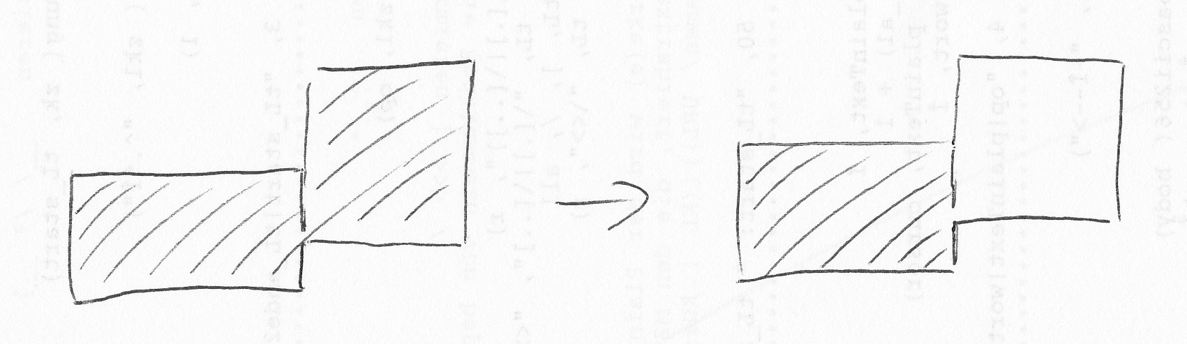

Thanks for the offered help in terms of commandline extension. Maybe I'll come back to it. However, it would be more useful for me ( and others?) to extend the functionality of "Magic Wand Inclusive".
When I uses this Function the selection sometimes breaks out because of a "wrong" colored Pixel. Usefull would be an algorithm which detects such leaks ( 1, 2 or 3 pixels wide). At the end should be a rectangular selection.
