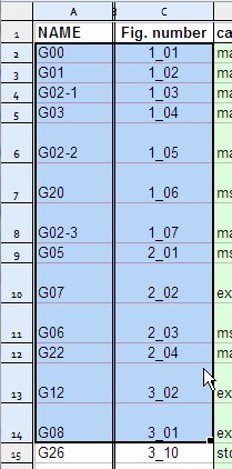

first I need the filenames, old and new correctly synced in spreadsheet
the second column are the current names,

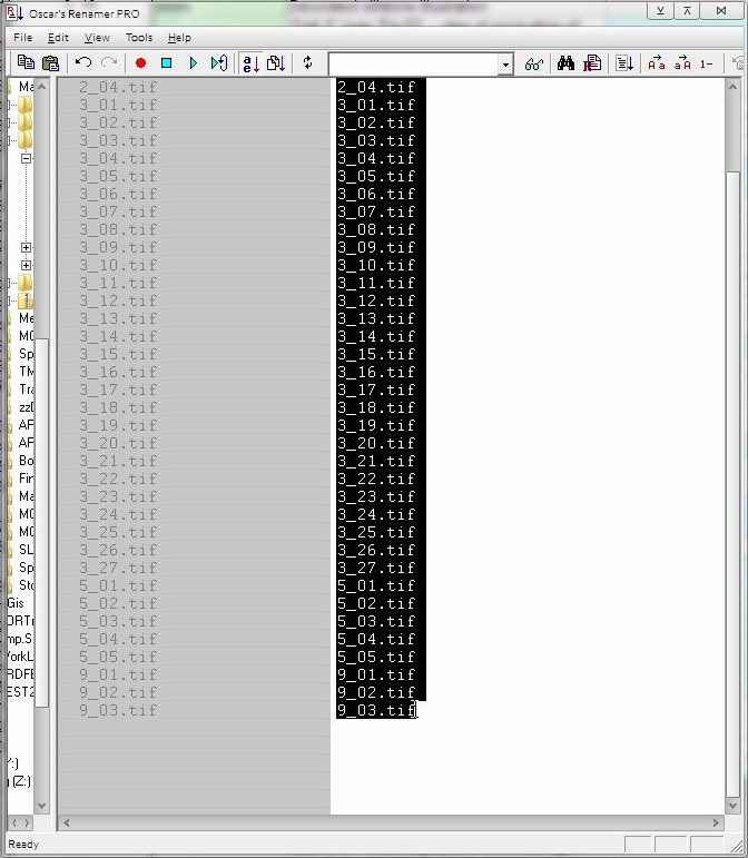

open Renamer,
select relevant folder - a doubled list shows in the main pane:
renaming is in the right column, so select that list
(I've reduced the tree pane on the left for the screenshot)

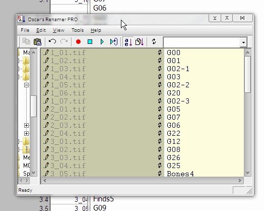

Copy relevant cells from your spreadsheet, and paste in Renamer (might be best to paste in text editor first and then copy again ensuring you have exactly the correct number of lines):
I think it was then:
menu: File > Apply changes to folder
Hope that works for you -- I did have to mess around a bit, but was doing it 'cold' :D
