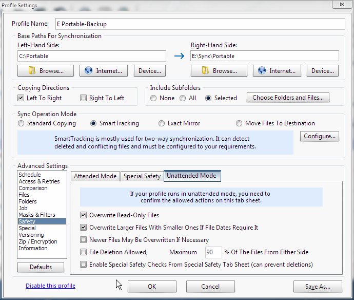

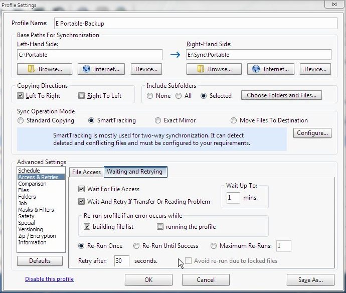

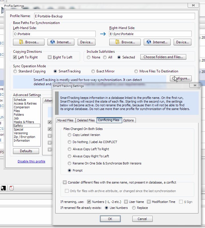

I use Syncovery myself: subjectively very fast; again very accurate; partial file updating; can find moved files and move at destination rather than delete/recopy. It can ignore conflicts (there are a few options, let me look there), and send you an email if there's a problem (or if there's no problem as well).
But I havent really used it in this type of scenario so cant say a whole lot more about it.
I actually cant find the email notification setting in Syncovery, I know it's there, I have it enabled for at least one profile :-/
Some relevant options:
see mouse arrow for how to access this dialogue (below):
