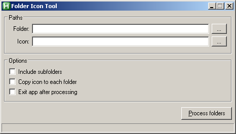

Apologies for the delay; here's my offering: FolderIconTool

I tried under Win 7 and 10 to change folder icon with right click-properties-customize-change icon
Windows writes in both cases IconResource=XXX.ico,0, so we can delete
IconFile=XXX.ico
IconIndex=0
completely. It is not needed at all.

FolderIconTool
If it is not hard for you, please replace
IconFile=XXX.ico
IconIndex=0
with
Does it really matter
IconResource=XXX.ico,0 has more priority, if desktop.ini already has it, IconFile will be ignored.

Please re-download and see if this version works as you desire.

if this version
It seems perfect now. The last problem is not so important:
we have to say windows explorer to refresh folder's icon. If a folder already had an icon, it takes forever to see the new one.
PS: c.gingerich's app uses the whole window for drag n drop and automatically detects where ico and folder should go, so it is more convinient on a touchscreen.
