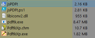

Requires the files from PDF Toolkit either extract them from the setup file using UniExtract or install it and then copy the files into the same folder as the script, (then you can uninstall it).
So your folder will look like this:
Run jsPDFt.ps1 using the shortcut.
Hopefully it'll work - it did here.
