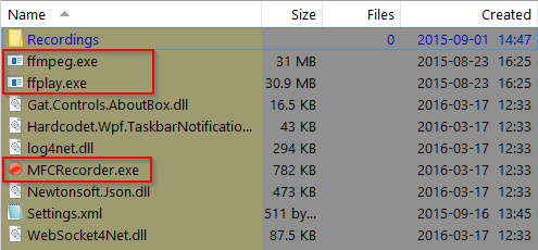

Just tried it on my machine Win10Pro x64 and it worked fine, here's what your folder contents should look like:
The marked files need to have internet access.
NOTE: Those are the 32bit versions of FFmpeg and FFplay, (and probably not the latest: ffmpeg version N-74593-g6638e4a).
And what should be allowed through the firewall:
Settings.xml should look something like this, (model was chosen randomly):
Code: ( xml)
[attachthumb=1,msg402811]
[attachthumb=2,msg402811]
Code: (XML)
<?xml version="1.0" encoding="utf-8"?>
<MFCRecorder xmlns:xsi="http://www.w3.org/2001/XMLSchema-instance" xmlns:xsd="http://www.w3.org/2001/XMLSchema">
  <ModelsInclude>
    <long>21562245</long>
  </ModelsInclude>
  <ModelsExclude />
  <RecordAboveCamScore>false</RecordAboveCamScore>
  <MinCamScore>0</MinCamScore>
  <HideExcluded>false</HideExcluded>
  <StartInTray>false</StartInTray>
  <UpdateTime>2016-09-30T11:46:14.4521518+10:00</UpdateTime>
  <OnlineModels>1407</OnlineModels>
</MFCRecorder>
My folder looks just like that. Same files, same with the config file. Tried with the AV off and i had no firewall on to add the exceptions, still nothing. I'm on Windows10 Pro x64 aswell. I have no clue why it's giving so much trouble.
Gonna try to find an older version of FFmpeg x32 and see if that works, mine is the newest build, or if you don't mind, send me a copy of your own folder without the recordings.
« Last Edit: September 30, 2016, 07:29 AM by PacoPaco »
