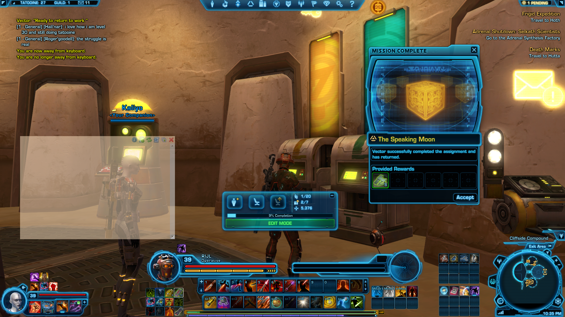

Ok, after playing around a bit, I think I might know why it's still not on top.  I have to figure out a good way to fix it... but after getting your flight sim up, select the window for TextOverlayTool.  Then position it over your Flight Sim.  I was trying it out with Star Wars: The Old Republic in full screen windowed.  At first it wasn't on top... but then when I focused it on top, and went back to the game, it worked fine (shown below).  I'm bringing the window back topmost when the window is deactivated, and without that deactivate, it's only using the regular topmost method.
Let me know if that works.
