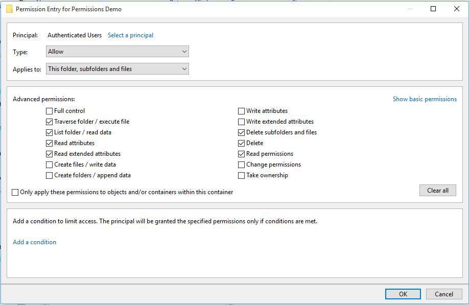

In a given directory there are sub-folders named "A" to "Z".  In this same directory many people just dump their files without alphabetically filing them.  This little batch script just went through the loose files in the folder, extracted the first letter of any file it found and moved that file to the correct folder based on its first letter.
Scripting is nice, but IMO you're solving the wrong problem. The permissions on the parent directory should be set as below for both Authenticated and Domain Users.
Subfolder permissions will need to be reset (to once again restore write access) after doing this, but the end result is forced honesty. Because nobody can create files/folders in the root on the tree...which forces them to put stuff where it belongs. They can however delete/move their existing junk to where it belongs. And if - by chance - you don't trust them to do the cleaning...omit the delete permissions.
We had huge problems here when I first started, because of the exact reason you describe here ... And then suddenly one day...the problem just vanished (by force..). :D
