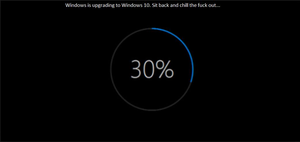

I didn't have any tech issues deriving from my upgrade, but I have to say I'm a bit surprised at Microsoft's crudeness:
« Last Edit: August 07, 2015, 09:33 PM by kyrathaba »
Re: PSA: Woe to Thee Who Performs a Windows 10 Clean Install
« Reply #41 on: August 07, 2015, 11:22 PM »
I... didn't get that screen.  I got the screen, it was just with a different title.  Was that a joke?  Or did that really happen?
kyrathaba
  • Posts: 3,200
« Reply #42 on: August 07, 2015, 11:51 PM »
Joke  ;D
« Reply #43 on: August 08, 2015, 12:58 PM »
Now ^That^ is funny.  :D Especially after spending the last few days staring at that exact screen...wishing it would do something interesting before I fell asleep (on site..).  :Thmbsup:
