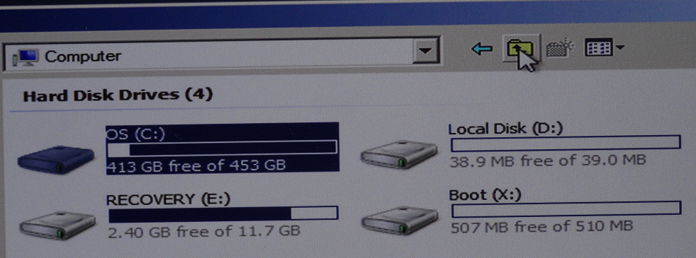

I'm still unsure how many partitions are in it:
1) The first mini-partition has DELL tools - it is shown and has a label (V:)
2) Second partition is Recovery, and is labeled with an asterisk* - and is not shown in e.g. file manager
3) Third is the OS (C:)
4) is there also a mini boot partition?? - read on:
System restore shows "RECOVERY ()" and 'C' and a "Boot (X:)" partition.
And Aomei Backupper also shows a "Boot (X:)" (from it's winPE boot disc) when I go to save the image (see screenshot)
Oddly this Boot partition is *not* shown by:
# Windows disk management
# Aomei PArtition manager
# Eassos PArtition Guru
# GParted
Note: the labeling is different in this image/dialogue (due to it being from a boot usb-stick). Important is the precence of Boot patition not seen by Partition programmes :-/)

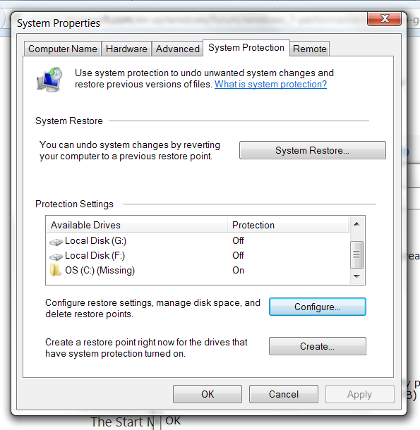

A while later, I noticed System Restore no longer worked.
I was trying to enable it for C but it refused to work:
Could not apply the settings for the following reason: The filename, directory name, or volume label syntax is incorrect. (0x8007007B)
followed by:
There was an unexpected error in the property page:  The filename, directory name, or volume label syntax is incorrect. (0x8007007B)   Please close the property page and try again.
Turned out there was a second phantom 'C' partition (hidden down the bottom of the list) with System Restore turned on. Once this is turned off, it turned on automatically for the 'real' 'C'.
(I found out how to do that via MS forums - seems to be common after restoring an image or a reinstall on laptops with funny [peculiar] OEM business on them.)
