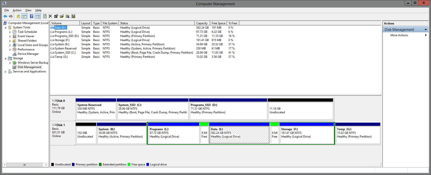

« Reply #15 on: July 26, 2015, 12:43 AM »
Default setting for Windows 7 is to make a 100MByte partition (on a spinning hard disk, SSD hard disks use a 350MByte partition for that same purpose) when installing on a unpartitioned disk. But if the disk already contains partitions Windows will use these however it sees fit. Anyway, if your system has such a partition, it becomes essential in the Windows boot procedure.
Not sure what to make of the first partition in your list, as I can't be exactly sure how the boot procedure on your computer was configured.
