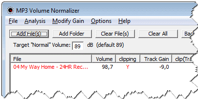

or maybe the converter in your Audacity's default setting is "Normalize Gain":

Curt, where is that window? I can't find it.
