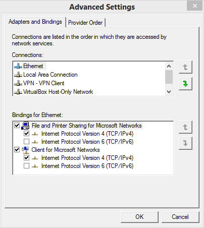

I don't know if it will help but what order are the adapters listed in under Network Connections->Advanced->Advanced Settings->Adapters and Bindings
And if it isn't, what happens if you move the Local Area Connection to the top?
Well I'll be!  That seems to have done the trick!  And you have shown me a corner of windows I never even knew about!

Thanks - TBH, I'd completely forgotten about that setting also until a couple of days ago when I was trying to work out why my internet connection was suddenly giving me my VM NIC IP and thus not working.
