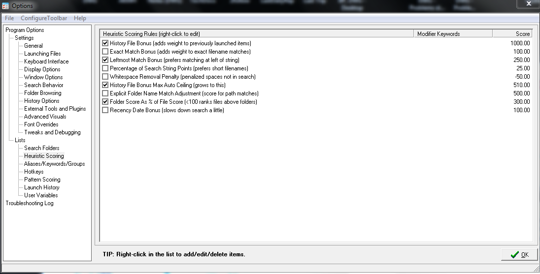

Current settings, searching "Mus" eventully scores 2724, then I click enter and the folder C:\MyFolder\Media\Music is launched in Windows Explorer!!
An intriguing thing is, If I then call FARR again, even without typing anything, I see that "Music" item is ready alredy on the list on top place but only with score 1000!!!!!!!!! And if I then start type "Mus" for a few instants that FARR redraws and that folder gets 645 points that will reach the 2724 seconds after...
My current settings:

Does this explain why yours isn't growing:
Is your second number lower than first?
Filipe Meira Castro
  • Posts: 104
I have 50 and 9000!! that's why this is strange!!!
