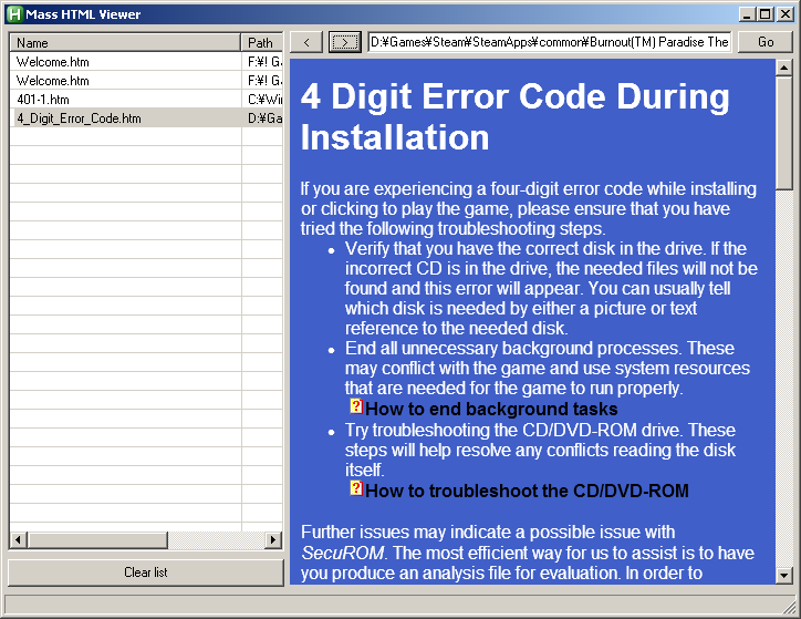

Give this a try:  http://skwire.dcmembers.com/apps/snacks/MassHTMLViewer.zip
Notes/caveats:
  • No frills.
  • Drag and drop htm/html/xml files (or folders) onto the listview and view away.
  • URL files are not handled (yet).
  • Nothing is saved.

« Reply #8 on: May 06, 2014, 02:21 AM »
Wow, that's sure beats dragging and dropping, Skwire.  And so fast acting.  Views are instantaneous.  Thanks very much.
Some of the .htm pages apparently give Mass HTM Viewer heartburn -- an error message pops up wanting to know if the 'script' should continue.  Most pages are fine, though.
Hope you can do your magic with URL files (web bookmark files) as well.
Great work, Skwire.  Another winner.

« Reply #10 on: May 08, 2014, 08:43 PM »
Please download again: http://skwire.dcmembers.com/apps/snacks/MassHTMLViewer.zip
Error popups should be reduced, URL files are supported, and the statusbar updates more like a real web browser now.
