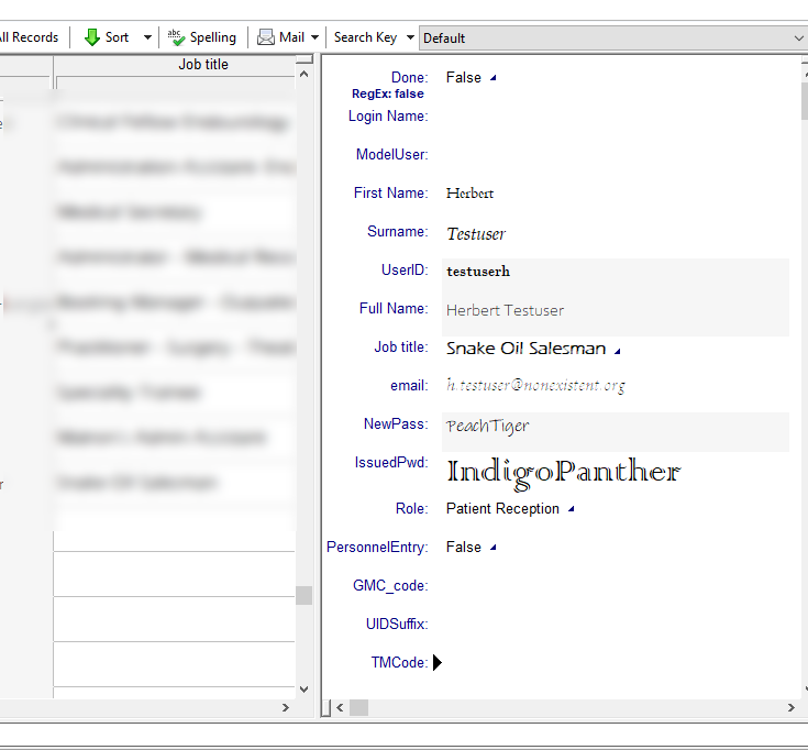

I intended to post a screenshot of a form view of a data item and discovered that my colleague has been playing with some of the design elements. Specifically fonts. Oh dear. Still, I guess it illustrates something:
There are four dropdown lists: three for predictable / static choices, one (job title) for a good way of accumulating things that might be reusable in the future and will save typing.
There are a few calculated fields -- UserID is either surname+first initial all in lower case (as illustrated) plus any content in the UIDSuffix field so you can deal with the 50th John Smith who rocks up... but if Login Name has content, it'll be that instead.
NewPass is a calculated field chosen by gluing together a randomly chosen attribute (usually colour) and a randomly chosen animal, from a separate table in the database. The calculation that handles that is very Excel-ish
Code
=concatenate((vLookup_ex("PasswordConstructor",(int(randBetween(0,22))+1),"Row","PassA",0)),(vLookup_ex("PasswordConstructor",(int(randBetween(0,22))+1),"Row","PassB",0)))
and as the random number generator does what they generally do, it calculates a new password (a) any time anything happens, and (b) any time you press F9, so we pick one we like, ^C and ^V into the IssuedPwd field so it can be recorded.
What we do with this is use it to spit out a CSV of any records where Done = False and feed a mailmerge with it, after which Done is set to True.
Would that be useful to you? Probably not. If  DIY databases were popular, there'd be more of them and people would use spreadsheets for adding up. But if it's the sort of thing you need, you might not find a more cost-effective solution anywhere.
