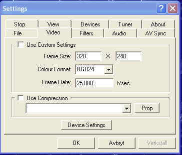

I also observed that the Default Video Frame setting was 320x240 as you can see from the image below
But, the preview monitor showed 640x480 which I believe is probably the source definition. Again, playback through VLC and just about everything else I've tried seems to be the correct ratio so it's probably not a problem - just more confusion. Yeah, you're right ...I seem to be easily confused.
I've attached below, the statistics produced by both VVCR and MediaInfo. If you could give them a quick look and verify they're what's to be expected it would be greatly appreciated.
The Use Custom Setting isn't checked so it's ignored - which is why I didn't mention it ;)
It will default to the resolution of the capture device and this is where we come to with this:
640x480 is not the resolution of the video source, it's 720x576 - standard PAL.
This is why I don't use the EzyCAP because it's default resolution isn't a television one - it's 640x480, which is standard VGA resolution.
I used it once - the only resolution I could get it to capture at was 640x480, which is definitely not the normal PAL resolution of 720x576.  At that point the EzyCAP was consigned to the cupboard never to see the light of day again.
I didn't care if it was scaling the input signal to produce a nice square pixel output, I wanted the full video frame to work with - which is why I switched to an internal TV card for capture.

As I mentioned above, you're capturing at the wrong frame rate, you need to set it for the same as I show in my post.
If that doesn't work then under Settings->Video, check the Use Custom Settings and set them to: 720x576 (may or may not be honoured); Colour Format YUY2; Frame Rate 25.00.
If VVCR complains because of the resolution then you might have to change it to 640x480.
