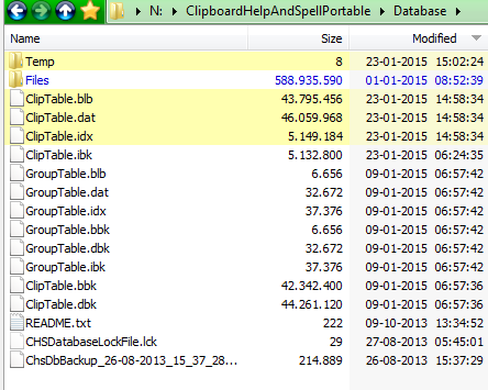

Example:
-change from [new]  to  [old]
(under the \Clipboard tree)
- do a search, I type 2 letters and cannot type any further.
I then start doing something else for -say- 20-30 seconds, then I can continue, enter 1 letter and need to wait again.
- copy something to clipboard: the button in the taskbar shows it is busy copying, busy, busy
sometimes it take 10-20 seconds before it is completed
Think the database isn't too big..
28.000 clips

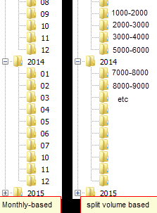

Up front.
I do not know whether the below it is a solution and/or whether it is feasable at all.
Just an idea...
But what about (optionally!)  splitting the clipboard, say in monthly or quarterly clips,
or volume based split?
Or split into:
-Recent  [2] Months   (e.g. keep clips upto 2 months)
-Old       [12] Months  (e.g. keep clips upto 12 months)
-Archive  (clips older than 12 months)
When searching:
-by default search recent
-if nothing is found, user can TAG search in 'old/archive' clips as well, which may take longer.
Well, I don't know, these are just 'wild ideas'  ..   :)

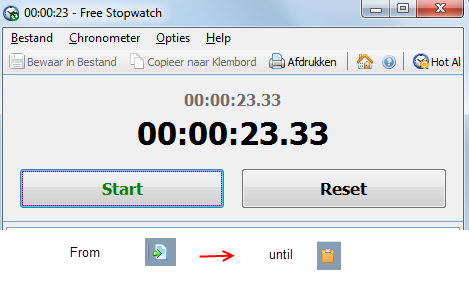

« Reply #30 on: January 24, 2015, 03:24 PM »
select text, ctrl c
start stopwatch
stop once the taskbar button changes into normal
for your info
