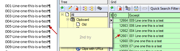

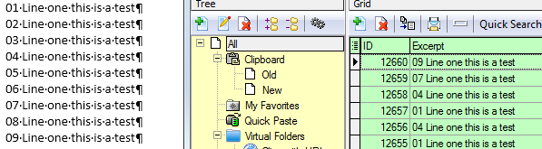

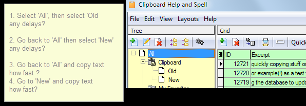

I'd like to know if about 9-10 seconds delay is normal, I mean to say, when at CTRL-C
it takes about 9-10 seconds before this -> [attach=#1] arrow button changes back to the normal taskbar-icon.
When quickly copying stuff one after the other, whilst CHS is still trying to save them, clipboard copies are lost.
For example(!) as a test:
have created a Word-document with numbered lines
selected each line
copied them to clipbard one after the other, not waiting until CHS has finished.
1st example
[attach=#2]
2nd example
[attach=#3]

It should be super fast and you shouldn't be able to copy fast enough (at least not manually) to make it miss stuff.
It's good that a clean install is super fast for you, now the question is whether there is something unusual about your database or just it's size...
Cliptable.* are the main database files.
If you bring up the main window can you check how big your Clipboard -> New group is? maybe try moving items from the New section elsewhere.
Also see if maybe it has to do with your current view? Do you have a filter enabled (top row), or are you in a virtual group?

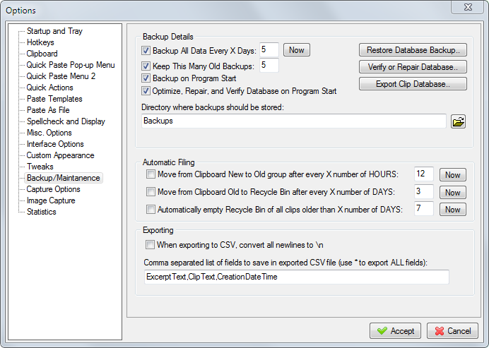

oddly enough the 'New' section is huge, the 'Old' one very small.
What dictates that? Okay, I seem to have disabled 'Automatic Filing' on the 'Backup/Maintenance' tab.
- I reactivated that and this seems to have sorted out the problem here - will report back if there's any related troubles.
(thanks jesse :up:)

If it's true that a large New section slows down everything, then i can try to add something that automatically detects it and tries to encourage user to enable auto-filing.
dcwul62, can you check the size of your New group as well and see if you have disabled auto-filing?
Sorry . . ., but how?
later:  you mean THIS ??

New group can be seen by opening the main window (you may need to open the 'Tree' panel).
By default 'New' gets moved to 'Old' after X hours.
if you activate the first option there under 'Automatic Filing' -- setting the number of hours (I have mine at 72).
I'm not sure does this affect what shows in the quick paste menu (?)

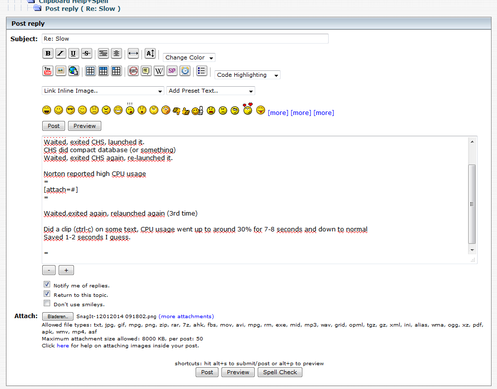

I just tried, did not want to cut back to 72 hours or so, but took 7 days (168 hours).
Clicked on [Now][Accept]
Waited, exited CHS, launched it.
CHS did compact database (or something)
Waited, exited CHS again, re-launched it.
Norton reported high CPU usage
Waited,exited again, relaunched again (3rd time)
Did a clip (ctrl-c) on some text, CPU usage went up to around 30% for 7-8 seconds and down to normal
Saved 1-2 seconds I guess.

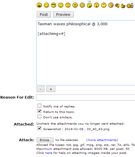

"when you modify your post, there's a list of attached files under the edit box - untick "
eh ... where to 'untick'?

On the "Backup/Maintenance" tab, tick all of those checkboxes under Automatic Filing, then click the Now buttons in that "Automatic Filing" group to the far right of them, in order starting at the top.
Take a screenshot afterwards if you would so we can see.
Then go to the main window and click on the "New" group, and make a guestimate about how many items are in that New group (dozens, 100s? 1000s?).
Then restart CHS and see if the problem is fixed.
Ah okay,
my explanation was for how to remove an image from a post which has already been posted. I then get this:
I think before posting, you cant remove the image, which is limiting...

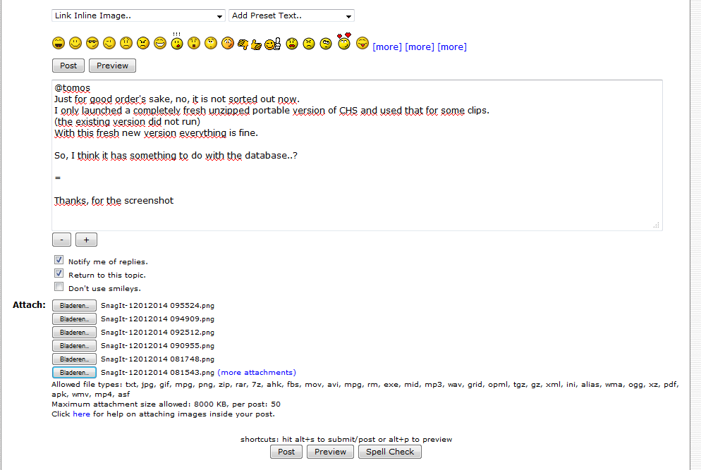

As for attaching files. Thanks for the screenshot. Seems only possible when modifying a  post that was already sent(?)
I did not test it, but what would happen if:
- I create a post
- attached a few files
- then decide nót to use them
a. how then to remove them?
b. if I doNOT use the 'link inline image' drop down, at the top, but send the post anyway (see attachment)
can these attachments be opened?
again: I  did *not* test it/give it a try  :-)

There is no advantage to keeping them in the New section, but really 600 items in New should not be slowing it down.
Truthfully neither should 6000.
But if we accept that the slowdown in your cases is being caused by so many clips in the New group, what we need to next determine is WHY.
There are a few possibilities.
  • The first is that simply having so many clips in the database is causing the database to update slowly.
  • The second is that CHS is doing some operation each time a new clip is added to the NEW group, like filtering, or invisibly updating some display that is involving sorting or searching, and that this action is being performed each time a new clip is added.  This would be a bug that we might reveal by changing the view on the main window in different ways and trying to see if the bug remains in all cases.
  • The third possibility is that an antivirus program of some sort is being an ass, and is holding up the program while it scans the clip database file as it increases in size or content.
Determining which of these causes is the key.  Any insight you can find would be appreciated.  What I can do is create a test function to create tons of clips in the New group automatically and see what i can see.

Back to CHS - I did not understand your previous post. Thanks for clarifying: "not sorted" - more :-(
I have 30,000 items in Old'.
I have about 150 items in 'New'.
As it is now working well here, it seems clear that the problem (again here) was with too many items in the 'New' section.
You have almost 600 items in 'New'.
  • First question is: *why* do you want to keep them in new/ not move them to old? (Related question for mouser below.)
  • Second question is why not try it with less than 200 in 'New' and see if it works?
Query for mouser: is there an advantage to keeping an item longer in the 'New' folder?
Frankly, I don't know if this is the cause of the problem. Thing is, if I take captures quickly, then CHS is unable to follow and starts skipping. Maybe it is something between Windows clipboard and CHS and something to do with buffers, I don't know  ;)
Some years ago, I had a tool (written in Visual Basic) and in case of large volumes of renaming files, it sometimes used a lot of CPU sources and crashed in the end.
After some communication with the developer he increased some 'buffers' somewhere and it worked fine ever since.
I don't say it is the same, I don't have any knowledge of programming whatsoever,but as CHS is taking (too) much CPU resources and skipping things, I was thinking of the buffer-thing from the past.
Anyway.. it is upto Mouser

« Reply #22 on: January 13, 2014, 01:27 PM »
Try this:
1. Select 'All', then select 'Old
any delays?
2. Go back to 'All' then select 'New'
any delays?
3. Go back to 'All' and copy text
how fast ?
4. Go to 'New' and copy text
how fast?
when I select subfolder 'New' then it is much faster.
Re: Slow
« Reply #23 on: January 13, 2014, 01:37 PM »
^ I tried that:
  • 1. delay is between .5 to 1 second
  • 2. much longer delay - a couple of seconds
  • 3. unclear -- do you mean leave CHS main window open? I did leave it open and copied nine small clips quickly from Notepad2 - only five were actually copied.
  • 4. as 3 -- but nine out of nine clips were copied

« Reply #24 on: January 14, 2014, 09:26 AM »
This proves what I am trying to say.
When selecting 'All' (top level) copying is slow and CHS skips things.
Then go to 'New' (select New in the tree), copying is fast, nothing is skipped.
Maybe a workaround could be: CHS to startup selecting 'New' by default, i.e. startup folder='New'
Currently 'All' is selected.
Of course, that is not an answer as to why CHS skips copying, because too slow, in case 'All' or 'Old' is selected.
