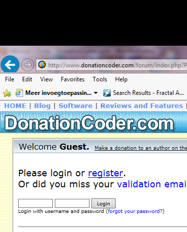

When I invoke SC my whole screen goes down and leaves a black bar above it.
http://i.imgur.com/wz9uCXA.png
I have this with both portable versions of 3.8.1 and now 4.8.
So I heavily suspect it has to do with Windows updates I "stupidly" allowed a few days ago for all kinds of .NET stuff.
Could that be it?
The problem is not inconvenient to me yet. Just letting you know.

unlikely.  it sounds like perhaps some kind of bug with sc identifying the screen dimensions..
does it ONLY happen when trying to do a select-region capture?
what OS?
how many monitors do you have?

Win 7 64b
Thanks & good call!  :Thmbsup:
You just reminded me I've been testing a Samsung T240HD [1900x1200] through the HDMI of my nVidia GTX-460 as a 2nd "TV screen."
If I disconnect the HDMI, the problem is fixed.
My main screen is 1280 x 1024
I only use select-region capture.
Do you want me to test other methods or anything?

SC should work well with all manner of multiple monitors, but your setup is probably whats confusing it, for some reason..

« Reply #4 on: December 16, 2013, 08:05 PM »
OK.
I just tested a bit (not all options).
The first two under (menu) Capture don't do it.
But "Grab Fixed Size region" also does it.
I'll see if I can live with it. I mostly think so, or a trick may turn up :)
