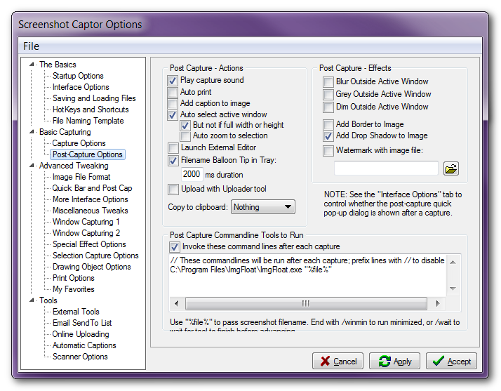

Can someone post a shot of how it's supposed to work?
I must be missing how this works.
Followed the setup directions but not getting it.

your screenshot looks correct... and you're using the default SSC settings, i.e. let it name and save the image, correct?

Check in C:\Users\<username>\AppData\Roaming
Is there an ImgFloat.config?  And/or an ImgFloat.log?

And you are using the standard SSC settings, correct?  Plugins don't get called on save as, I found out.
yes saves with date and time
i use the pop-up dialog

the only other thing I can see is perhaps you have to put the executable path in quotes since you're in program files, i.e. the space in the file name?  When I originally tried it that way, it worked... but maybe you do need quotes around it.
If that doesn't work, just to troubleshoot, I'd suggest putting it somewhere other than in the program files directory, and using the portable config, and seeing if that works.

I have it work by dropping the file onto ImgFloat.exe, but that's all.
With the ImgFloat service running.
How do you start ImgFloat?

Just tried it on a totally different machine that hasn't had it on it at all.  You shouldn't need the quotes.
The sequence is as so (one of the reasons I haven't done the help yet is to see what kind of problems people have)
1. Invoke your screenshot.
2. Choose any option other than save as and follow through with that option (the file has to be saved before it can be shown)
3. The imgfloat window should appear.  The first time there will be a slight delay.

So you're saying that you drop a file onto imgfloat.exe and it runs and you see the image?  Then the program is working- it's something with how SSC is working with the image that it's not calling imgfloat at all.  We might need to ask mouser if there are any other cases where the external tool is not invoked.

How can I run it as a portable?
Or did I already by dropping the file on the exe.
Re: NANY 2014 Release: ImgFloat (a tool for Screenshot Captor)
« Reply #39 on: December 28, 2013, 05:35 PM »
you run it as portable by copying the config file from the portableconfig folder into the folder with the .exe.  This won't work in the program files directory, as I won't be able to write to it.  But you've answered the questions that needed answering- it's something to do with SSC calling it, not ImgFloat directly.  I dropped mouser a PM, and maybe he can shed some light or ask you the right questions about how you're invoking SSC.

I typed the command line in manually and it's working now.
Must have been something in the copy/paste operation.
