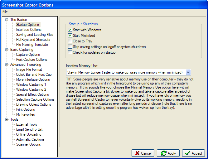

this is on a PC running WinXP SP3 and i have enabled SC's internal option for starting with Windows.
this is the current settings. (but yet to reboot..)
