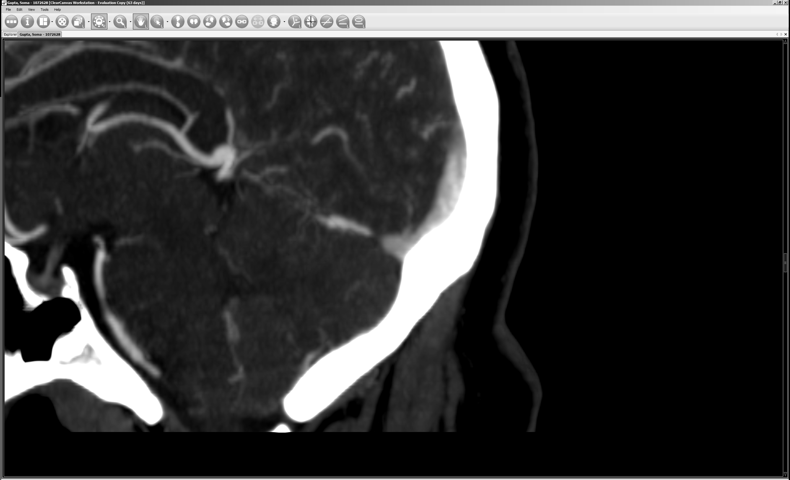

What I need to keep in the center of the captured window is a vessel in the brain on a CT scan.  On the first images it is near the bottom middle of the image and on subsequent images it wanders over to the lower left corner and then up to the left side.  I would need to drag the CT slice so the vessel is in the exact center of the capture box on each image.  This would involve moving it a few pixels when going from one image to the next.

the area of interest is the gray triangle in the center of the image
