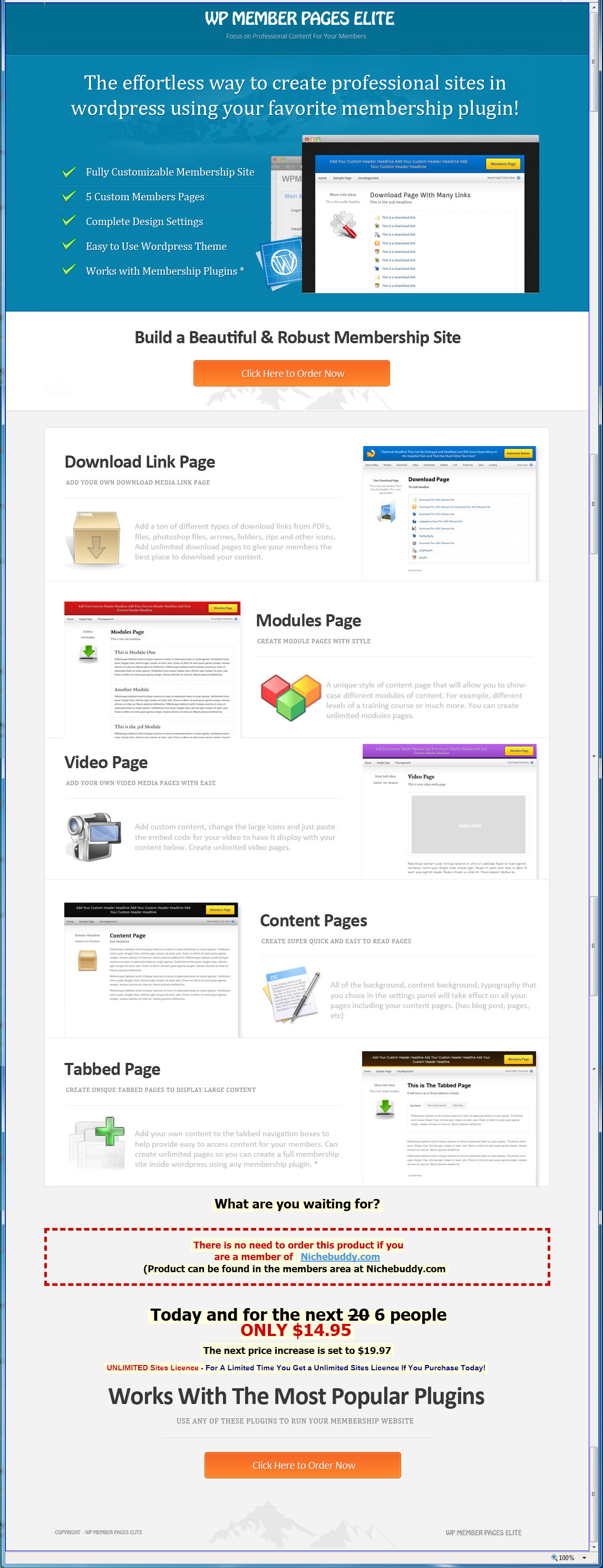

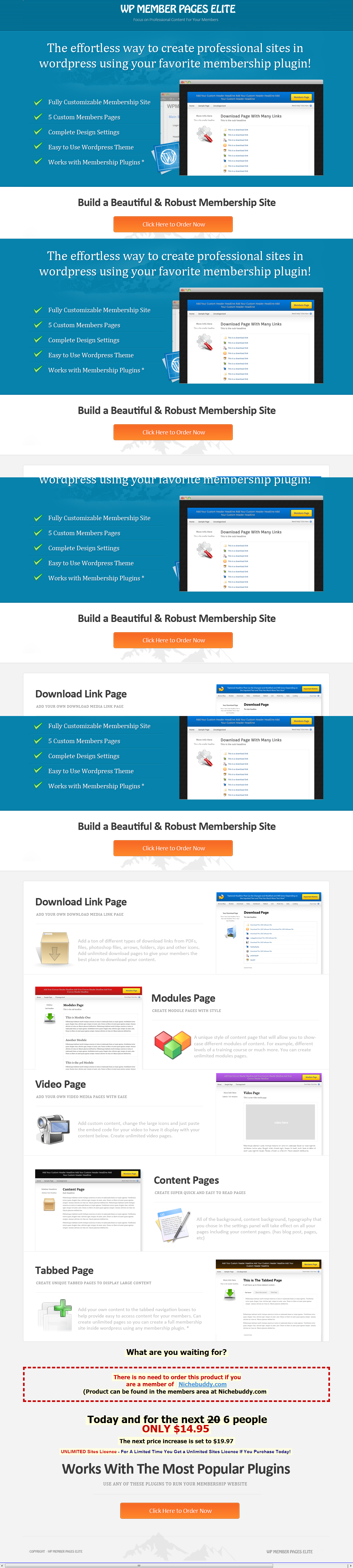

I am using v 3.08.01
Since I last updated to this version, I have seen an issue that happens very frequently.
1) Right-click on SC Tray Icon and select "Grab selected region".
2) Click the "Gear" on the SC selection frame, and select "Object selection mode".
3) Select the desired object (IE Client Window) and let SC auto-size the frame to the object.
(Typically, I size the IE window so there is no left-right (Horizontal) scrolling required)
4) Click the "Gear" on the SC selection frame, and select "Capture Object with AutoScroll Now"
5) SC (usually) goes through the motions of scrolling the IE window correctly.
6) If SC didn't scroll the window correctly, then the captured image is incomplete (as expected). Usually forcing the "Focus" to the desired IE window and repeating the capture fixes this.
7) If SC DID scroll the window correctly, sometimes it will capture the image correctly, but sometimes it won't. Sometimes, I can try over and over, many times, and I continually get an incorrect image capture.
This has happened once in a great while with previous versions of SC, but with this version of SC, it happens frequently... about half the time.
Usually, when it fails, what I see is that the first (Top) frame of the capture is correct, and the lower frames that are scrolled into view are all (or mostly all) present, but some "bits" of the first (Top) frame are superimposed (overlaid) on-top of most (or all) of the lower frames.
Sometimes, it is big chunks of the first frame, and sometimes it is little-bits from the first frame.
Here is an example...
Using AutoScroll capture:
Using multiple Selected area captures and manually stitched together:
Here is the URL for the captured page:
example-captured-page

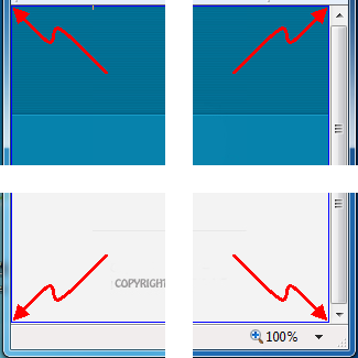

Also, a minor point... After using SC to capture an IE9 page, sometimes it will leave a blue outline around (inside) the client area of IE as shown in the previous examples, and here:
This doesn't happen every time and I have seen it with previous versions of SC. Refreshing the IE page removes the blue outline.

SSC red fixed region boundary lines make a slightly too small area - episodic bug?
When you press Shift+Ctrl+Prt Sc, red fixed region boundary lines automatically appear as a rectangle around the active window.
Sometimes these image boundary lines make for a slightly smaller area than that of the object selected.
This has only happened twice to me and is so far not something that I can deliberately invoke:
This is the image captured when the boundary lines made a slightly smaller area than that of the object selected:
Image captured via OneNote capture.
