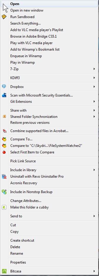

Also, positioning of the mouse so that it "points" to the exact sub-menu item that I want to emphasize when sending a quick "how to" to friends, etc. sometimes can take more than 5 seconds. For example, how to get the "Share Link" on a dropbox file, by right clicking on the file, then moving mouse over to "Dropbox", and then to the correct submenu... I have a large right click menu! (attached).
My other program "PrtScr" has a 5 second delay, so I'm familiar with how much I can "set up" within 5 seconds!  haha. Sometimes it isn't quite enough time, depending upon the complexity of mouse movements needed.

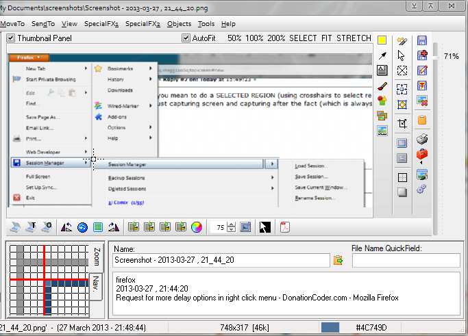

However, I've attached a quick screen capture of an example...
Re: Request for more delay options in right click menu
« Reply #7 on: March 27, 2013, 01:49 PM »
Ah.. so you mean to do a SELECTED REGION (using crosshairs to select region at time of capture) capture, with the menu showing.. Indeed if you're dead set on not just capturing screen and capturing after the fact (which is always my recommendation), then a delay is what you have to use.

Capturing a full screen and editing after is very quick and easy. A selection box automatically selects the active window. This can be easily and accurately adjusted.

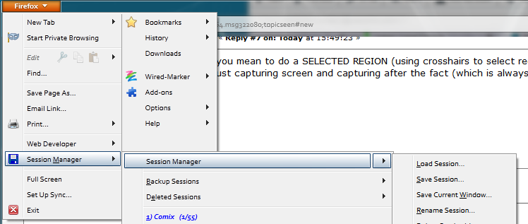

Here's my cropped screenshot:
and below the main part of the SC window. In the box bottom-left, you can see a pixel accurate enlargement of where the cross-hairs are,
making it very easy to select an area accurately for cropping:
