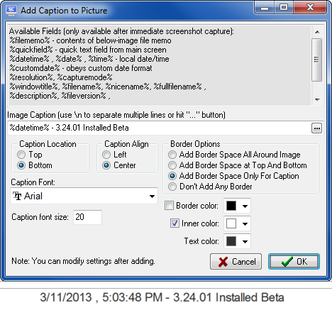

I'm hoping I'm wrong but it seems I'm seeing problems with captions again.
Testing the latest update today.
What I have placed in the 'Add Caption to Picture' in configuration is displayed. But it is not picking up what is being added from the pop-up prompt.
I've tried just pressing enter after adding something in the short comment line. Also tried by pressing the save and show button.
Same applies using the [...] button.
I'm seeing the info from 'Add Caption to Picture' and that is all in each of the cases.
What additional info can I provide?

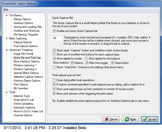

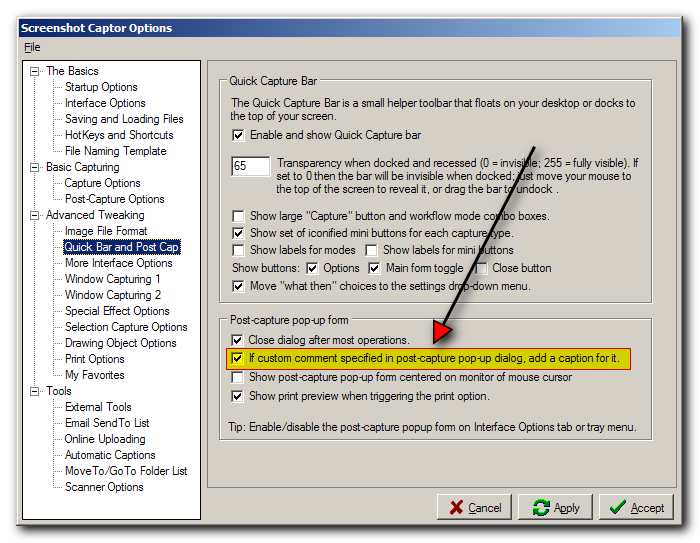

There is an option to specify whether what you type in the post-capture popup dialog gets added as a visual caption or just gets added to the comments box at the bottom.  It's on the "Quick Bar and Post Cap" tab of options:
Can you check that setting?  However if you didn't change it there's no reason it should have stopped working spontaneously.
bob99
  • Posts: 345
Re: Screenshot Captor 3.24 Beta Test - Mar 10, 2013 - Feedback Wanted
« Reply #182 on: March 11, 2013, 08:49 PM »
It is checkmarked.
It worked fine in 3.23.01. But 3.24.01 is the one that seems to have the problem.
I'm running it on two different laptops. Both Win7. Just tried Ver 3.23.01 again on the one that is running Home Premium (if it makes a difference). It is working fine.
I have Ver 3.24.01 running on a Win7 Pro. It is the one not bringing up the pop-up prompt caption.
Previously on the tests I had been running a portable version in an HD partition I use for portable programs. To see if this might be causing the problem I deleted it and did an install of version 3.24.01. No change.
Here's the other screen relating to captions for the settings I have just in case.
I added something to the default comment line just to see what would show up.

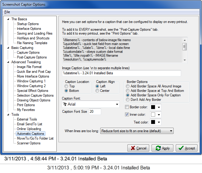

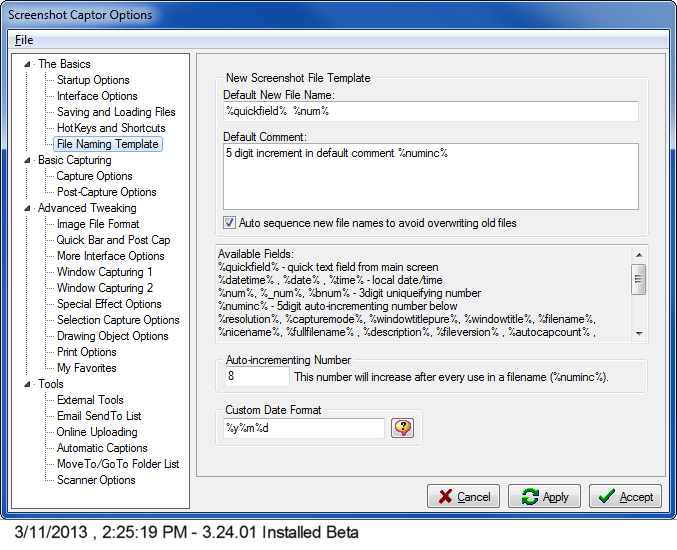

can you should me your "Automatic Captions" tab?
bob99
  • Posts: 345
« Reply #184 on: March 11, 2013, 09:28 PM »

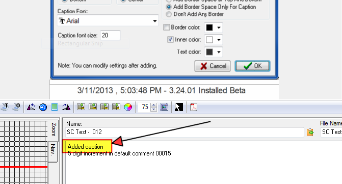

This is how it was. I had added text.
I went ahead and deleted "%datetime% - 3.24.01 Installed Beta" from the configuration window and then took a shot of the toolbar option.
Here's what I got.
Before selecting save and show I typed in "added caption"
This is how it shows in the main window. Time stamps are the same, "Added caption" not there.

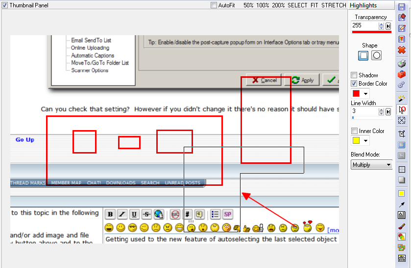

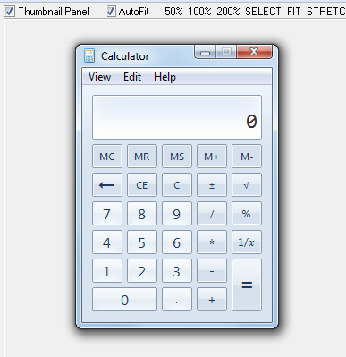

I'm getting used to the new feature of autoselecting the last selected object when going from Object Selection back to Normal mode. I'm not sure I like having this always be the default action. I do like the feature to double click to get in/out of Object mode. This seems to be more how I would have expected it to work. Although I seem to be in the habit of trying to always hit the <Esc> key to get out of Object select mode instead of double clicking to get out of the mode.
Not sure if you've answered this before here or not, but when in Object selection mode and you attempt to draw a box around multiple objects to select them, the outline of the box that is drawn on the screen many times looks really funky, not a pure rectangle. As you move the mouse around the objects while holding the left mouse key, the shape even morphs as you go around different objects. It's confusing as I'm not sure if I'm goint to get all the objects selected.
I've captured what I'm talking about in the attached screenshot. See the thin black line that gets drawn on the screen as I try to go from lower left to upper right to select all of the red boxes?

bubba, i know exactly what you are talking about regarding the funky black selection when doing object selection.
let me ask though -- it does select the right things when you let go of the mouse right?  it's just the display while dragging is confusing right?

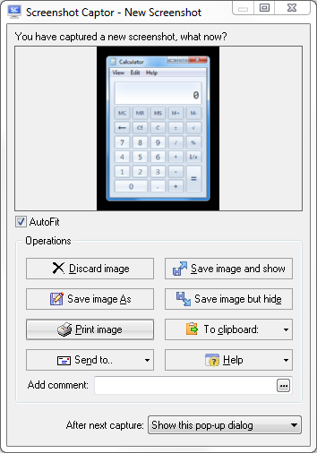

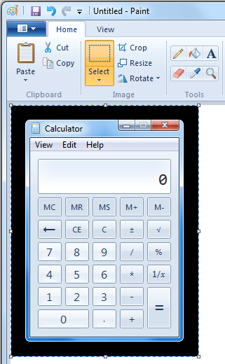

1) I've mentioned it before, but I think the default for "Window Capturing 1->Auto-remove area outside border with alpha less than..." should be 0 rather than 200, so it will capture the shadow when the shadow is present. Otherwise the default is to capture it in a way that is different f4rom what the user can see which seems odd IMO.
2) The thumbnail of the window capture on Prompt after capture, and the image copied to the clipboard (with above setting set to 0) has a black border, whereas the image shown from Save image and show has white border with shadow (which is what's expected)

Here are three screengrabs showing what I see on Prompt dialog, clipboard image pasted into Paint, and saved and opened in SC:
« Reply #193 on: March 12, 2013, 01:06 AM »
Right ok, i gotcha -- sometimes a picture really does speak volumes.
I'll make the popup background match main window, IF I CAN.
Actually now that i read you saying the copy-to-clipboard function also has black bars, i'm thinking that i must do the advanced background removal AFTER the post-capture form -- if so then fixing this is more difficult.. and may have to wait for a future version..

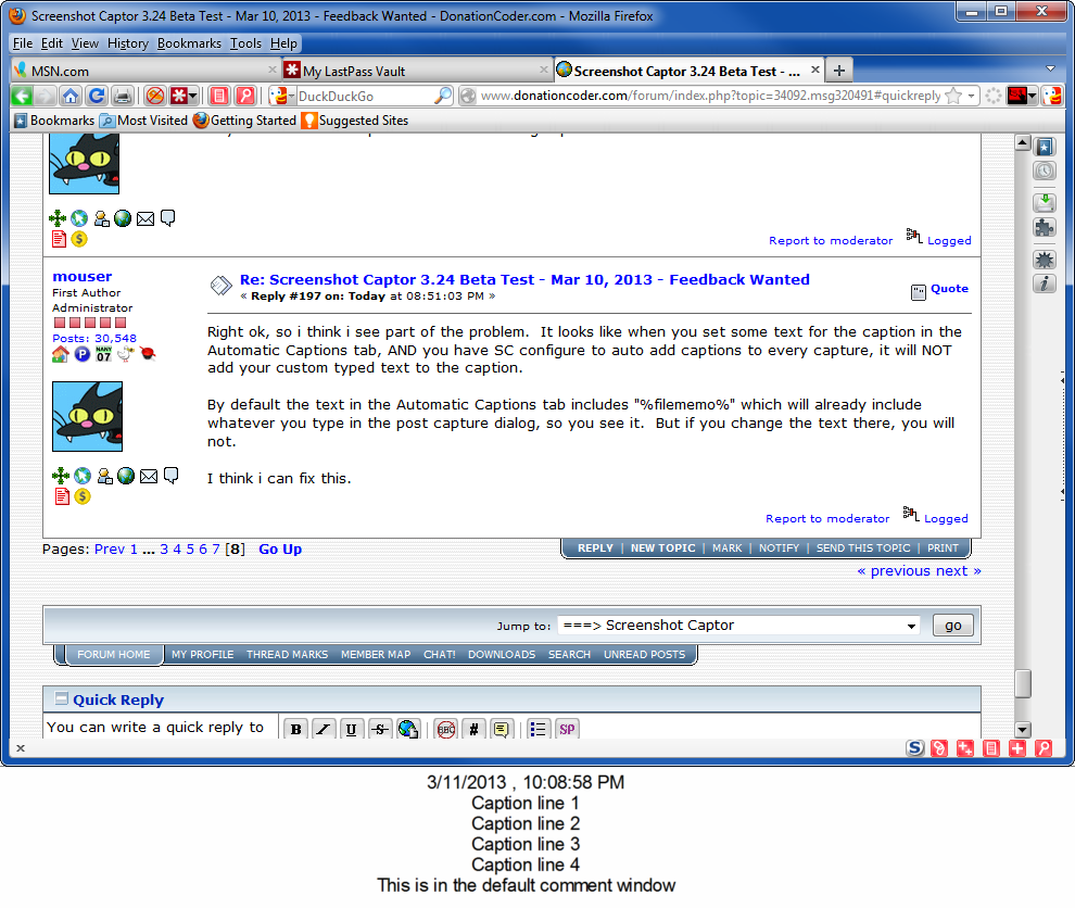

Right ok, so i think i see part of the problem.  It looks like when you set some text for the caption in the Automatic Captions tab, AND you have SC configure to auto add captions to every capture, it will NOT add your custom typed text to the caption.
By default the text in the Automatic Captions tab includes "%filememo%" which will already include whatever you type in the post capture dialog, so you see it.  But if you change the text there, you will not.
I think i can fix this.
