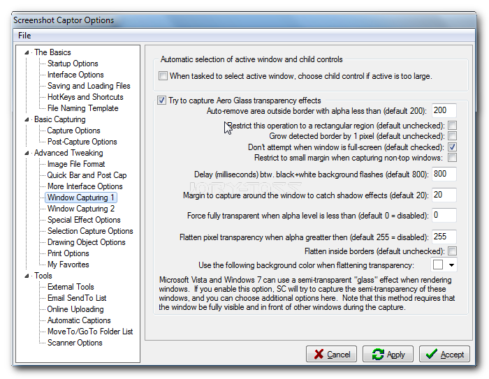

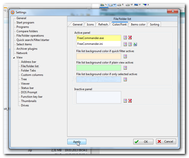

Using SC 3.29.01 portable on win7x64sp1; trying to capture the Settings (child window) of FreeCommander XE using "Grab Active window"; the border includes parts of the main app. Works fine with different other apps. Might be some bad setting?
SC settings:
Thanks!
I am a 3D body trapping a single dimension soul.
hi joby.
This is a known and low-priority issue that happens when you are trying to capture a semi-transparent window which is a child window in front of a main form.  Basically the parent form refuses to get out of the way to let SC figure out the background transparency.
I may have a look at the issue again sometime in the future.
Thanks for the report though.

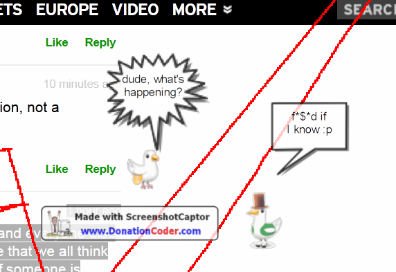

Wanted to publicly thank longtime dc member app103 for the great clipart she has made for Screenshot Captor; if you've never used the Clipart feature in the program, now would be a good time to try it -- there are some useful items in there.  :up:
You're welcome.  :)
bob99
  • Posts: 345
For some reason I hadn't tried the clipart feature until recently.  :huh:
It's very useful and something I'll be using more now.
Thanks app103 for providing the updated clipart.  :Thmbsup:
If anyone has any suggestions for more clipart they like to see me make, to be released as add-on packs, there is a thread for requesting it, here: http://www.donationcoder.com/forum/index.php?topic=34110.0
Clipart is fun :)
