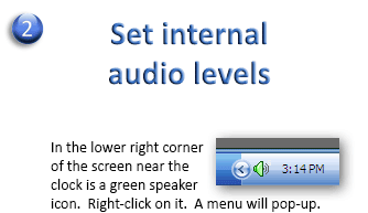

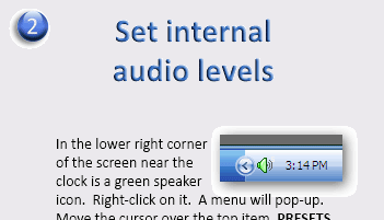

When I use Frameless to display an animated gif that I created in Photoshop CS6 it renders shadows in white and turns the white background grey.  See the attached images for a comparison between how it's supposed to look and how Frameless renders it. I tried merging the layers in Photoshop but that killed the animation.
(as displayed in Irfanview)
(as displayed in Frameless)

Apologies, I didn't see this thread here until today.  However, I did answer your email to me with the reason why you're seeing the white shadows.  For posterity, here's my email reply:
Some background on how Frameless works might be in order here.  For all supported image formats except for GIF files, Frameless uses the standard Win32 picture control.  That said, the control DOES support GIFs but not animated GIFs.  So, for GIFs, I use a third-party control that supports animated GIFs.  However, based on your sample, that third-party control doesn't appear to support the type of transparency in your file.  Unfortunately, there isn't much I can do about it; I'm somewhat at the mercy of the control.
