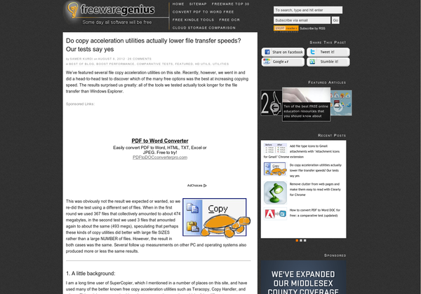

I'd love to hear your take on this: Samer from freewaregenius concludes that copy acceleration utilities on Windows make things actually worse:
http://www.freewaregenius.com/do-copy-acceleration-utilities-actually-lower-file-transfer-speeds-our-tests-say-yes/
What now? Do copy acceleration software works? From a technical standpoint, can it work?

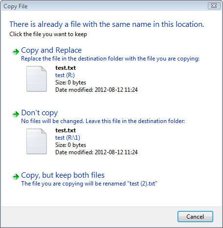

file copying in Explorer in Windows 7 is sometimes slowed down by having to deal with dialogs like this
It is sometimes useful but I dislike that it pops up even for files that are exact copies. A smarter file manager would do a file hash comparison and skip copying that file if the hashes match, all in the background.
That would be pretty disastrous speed-wise - definitely not something you want for a general file-copying routine :)
I think it could be designed to avoid speed-problems in many use cases. First, the hashing would only be done for identical file names in source and target folder. Second, the user could configure how large files to do the automatic hash check for, depending on system speed and user preference. For example if the operation only ran for same named files under 100 Megabytes in size then would there really be any problematic slowdown on computer with a newish CPU? If you are copying thousands of files with name conflicts then yes, delays will add up. But a smart file manager could also calculate the total number of such conflicts prior to operation and, if the number reaches some upper limit, skip auto hashing and display the regular interaction popups (including the checkbox labelled something like "do this action for all similar files"). So smartly designed it could avoid the possible slow-down cases and still save the user time and attention in all other cases.
CPU speed isn't really your main concern - something like Adler32 is pretty damn fast and "probably good enough". MD5 is also pretty fast, and since you're just comparing local files and not trying to be cryptographically safe, it will probably be sufficient.
The problem is that you're doing disk I/O. Instead of "1 read, 1 write", you'll be doing "2xRead + CPU, THEN perhaps 1 read, 1 write". OK, since you propose to use hashing, at least the 2xRead will run at full disk speed, whereas compare-the-bytes would be slower (seeking back and forth on a mechanical drive kills performance). But there's still a lot of overhead in this!
Nod5
  • Posts: 1,175
Ok, but doing a SHA1 check on a 150 MB file takes about 0,3 seconds on my system. So a bit over 0,6 seconds for a hash comparison. That is not so bad, especially compared to how Explorer works now, requestion user attention and delaying the file transfer with a popup window with a lot of text.
