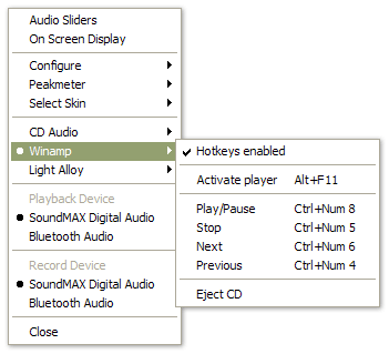

Take a look at Audio Sliders (http://www.codesector.com/mixer.asp), it can change default playback and recording devices with single click on its tray icon.
