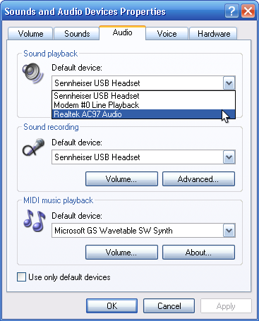

How could I make switching between the Realtek device and the Sennheiser USB headset really fast? :)
Normally, to do this, I have to do the following:
1. Click Start, Control Panel.
2. Open Sounds & Audio Devices
3. Select "Audio" tab
4. From "Sound Playback" devices choose the wanted device from the dropdown list
5. Click Apply, then OK.
6. Close control panel
In short, it's a huge pain in the ass and this really is something that I want to be able to do on the fly. Any ideas?

Re: A shortcut/hotkey to switch between audio devices?
« Reply #3 on: April 12, 2006, 06:36 AM »
What kind of macro?
e.g. this command below opens the Audio tab in your Multimedia Devices applet.
Code
RunDll32.exe shell32.dll,Control_RunDLL mmsys.cpl,,2
maybe someone here can figure out how to change the items in the combo-box via AHK...

Great start ...
Once the window is open you can use ALT D to make sure the device field is highlighted.
If the device names start with different letters just press the first letter to select the device and press return to close the window.
An AHK script to do this would be:
Code
Run, RunDll32.exe shell32.dll`,Control_RunDLL mmsys.cpl`,`,2
Sleep, 1000
send, {alt down}d{alt up}m{enter}
where m (in the last line) is the first letter of your device name.
If you make two scripts, one for each device you can just double click the correct device when you need to swap.
You may need to fiddle with the sleep delay too on your system depending on how quickly the window opens.
« Reply #8 on: April 12, 2006, 10:04 AM »
Common development.. Nice.
my 0,02$:
Code
WinWait,ahk_class #32770
This code should work a little better, since it waits for the window to appear.

where do I get them? I'm not sure what you mean by the names.
When you open the normal window the names are the ones you select in the drop down menu. Actually they are listed in your original post LOL
The first letters are S (Senheiser) and R (Realtek) - the script above already has the right letters.
All you need to do is download and install autohotkey (http://www.autohotkey.com/download/AutoHotkeyInstall.exe) save the script above via a text editor with .ahk as it's extension and then doubleclick the script file to toggle your sound card.
(I have attached the AHK script to this post in a zip file)
