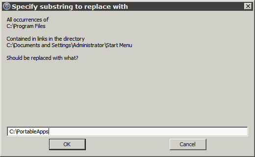

I have made a AutoIt script for this: LNKSubstringReplacer
Will replace all substrings specified with your specified desired replacement substring in all Target and WorkingDir fields of LNKs specified in a directory you specify. Also has a simulated mode to show you the effects of your replacement in a text file so you can see what is found and what LNK target substring matches you have.
LNKSubstringReplacer Link LNK Path Substring Replacer
