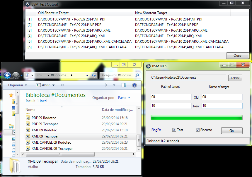

« Reply #41 on: September 26, 2014, 07:04 PM »
4wd, I hope you steel here 2 years later  :D
I'm trying to use BSM but I keep recieving this msg: Line 9834 - Error: Subscript used with non-Array variable.
I'm using BSM 0.5.
What I need is:
My shortchuts are in this folder: C:\Users\Rodotec2\Documents and I want to change the path and name of then monthly, so in September I'll have a path like this:
D:\RODOTECPAV\NF - Rod\09 2014\NF PDF but in October i need to change it for D:\RODOTECPAV\NF - Rod\10 2014\NF PDF
And the name are: PDF 09.2014 RODOTEC and I need to change it for PDF 10.2014 RODOTEC
Can you please help here?
Thank you for your work, i'm prety sure your BSM can solve my problem.

« Reply #42 on: September 26, 2014, 09:42 PM »

« Reply #44 on: September 27, 2014, 07:22 PM »
Yes, work in part.
I was able to change the path, this works fine.
But I couldn't change the name using the same search parameters..
For example:
I change the path from D:\RODOTECPAV\NF - Rod\09 2014\PDF\ to D:\RODOTECPAV\NF - Rod\10 2014\PDF\
Using the parameter 09 (old path) 10 (new path)... this works nice and prety simple
But I tried to change the name using the same parameters and nothing changes...
My shortuct names are like PDF 09.2014 Rodotec
Am I doing something wrong?

What RegEx are you using?
Screenshot of the interface, (for the RegEx), together with the Test window would be good also.

Re: DONE: Batch adjust shortcut targets
« Reply #46 on: September 29, 2014, 11:07 AM »
BSM shows Error: Subscript used with non-Array variable. for me
i'm trying to change Disk letter of all of the shortcuts paths in the start menu.
i tried: G:\\(.*) -> D:\\\1 , G:(.*) -> D:\1 , $G(.*) -> D\1 , "G(.*) -> "D\1
all give me that error with or without test&recurse checkboxes
« Last Edit: September 29, 2014, 12:36 PM by gendalf »
