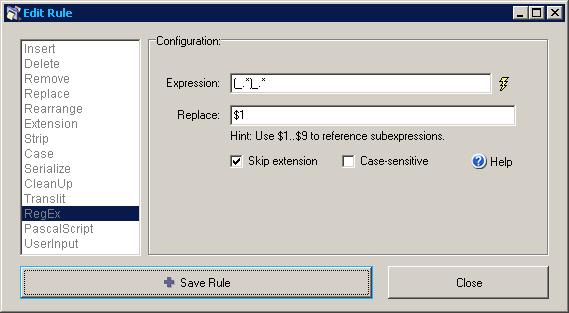

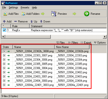

3) Add a RegEx rule like this:
4) You should see the preview change to this:
If you can't tell from the screenshot what the RegEx pattern is, here you go: (_.*)_.*

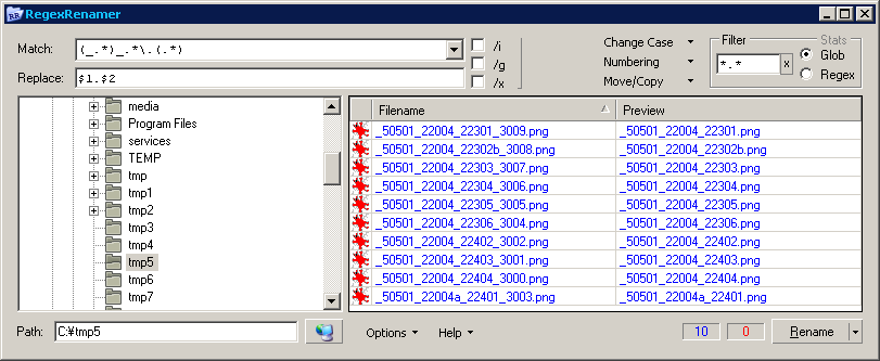

jgpaiva, nice find, that RegexRenamer.  Nick, if you choose to go with that application, here's a screenshot to help you along:

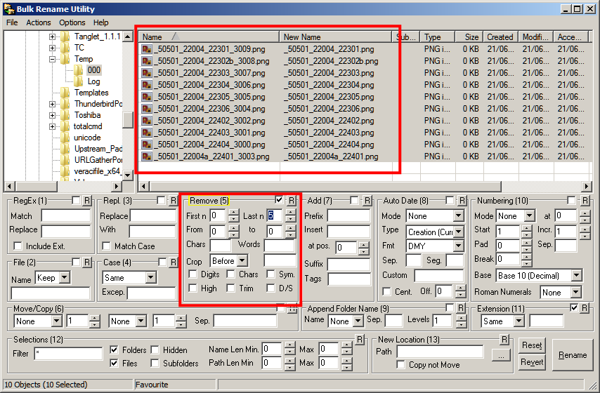

« Reply #8 on: June 21, 2012, 05:16 AM »
I've downloaded all three RegEx programs and will experiment when you provide the corrected code.
FYI, if you use a renamer like BRU (and there are many) they already have the funtionality to do that, ie no regex needed.
The plus is that you can see, in real time, what your changes are going to look like before you make them, so there's plenty of time to fine tune your parameters

Hi, for ReNamer to keep the last underscore, you can use: (_.*_).*
