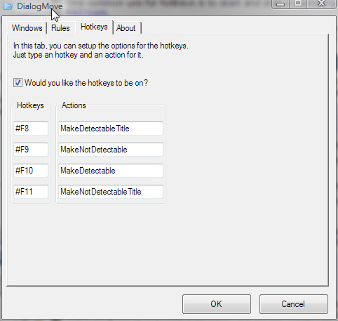

Well I enabled the shortcuts and clicked the one for
> MakeNotDetectableTitle
when the popup window was visible (& presumably had focus) and it's remained in it's corner since (good window!)
Re changing the shortcuts - it's difficult to know what works without doing a big experiment - I mean to say:-
I dont know how to type in e.g. Control key or Windows key - do you think should I use the Autohotkey shorthand for the different keys ?
thanks!
nudone
  • Cody's Creator
  • Posts: 4,119
Re: IDEA: move small dialog windows to cursor position
« Reply #170 on: April 16, 2009, 03:02 PM »
that is the correct procedure. if that doesn't work - because the title isn't recognised you can then try just MakeNotDetectble (without title).
the shortcuts for the hotkeys are the same as autohotkey's so:
# is winkey
! is alt
+ is shift
^ is control
eg. you want to use the winkey plus F11 to initiate MakeNotDetecableTitle, so you put the following into the dialogmove options:
#F11
or if you prefer...
