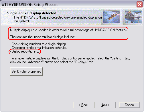

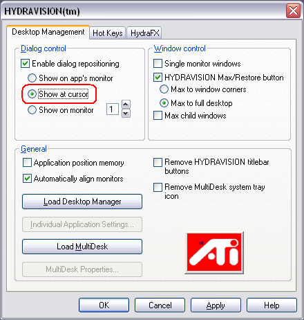

I was just looking through my computer and found ATI Hydravision, which had this option:
This might only work for multiple monitor setups (does not seem to do anything for me), but it's probably worth checking out.
Edit: It's confirmed, you need multiple monitors set up in order for this feature to work.

oh well, it looked promising for a minute.
