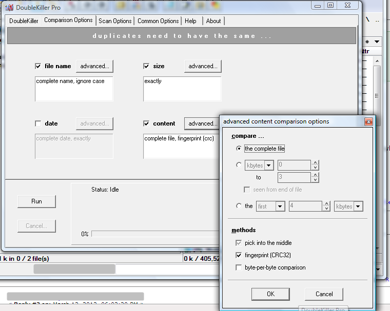

DoubleKillerPro has plenty of other options, though it doesn't mention streams.  There's a lighter free-for-personal-use version as well.
