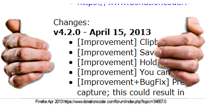

All is cool in 4.03.0
[attachthumb]
« Last Edit: April 18, 2013, 05:51 AM by cranioscopical »

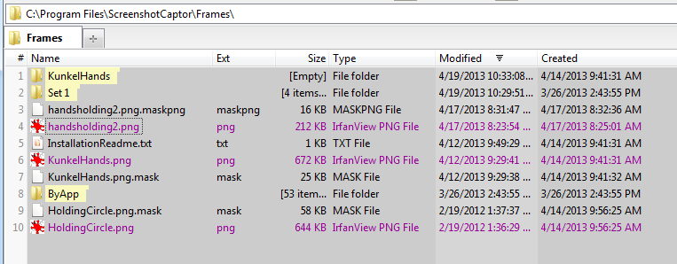

Here's my dir
Re: "Hands Holding" mask/frame combo...
« Reply #33 on: April 18, 2013, 09:59 PM »

Ok new test, download new copy of beta version and rename the mask to be:
handsholding2.png.maskpng
the first kunkelhands mask in the original zip is in jpg format so it should now be named:
KunkelHnads.png.maskjpg

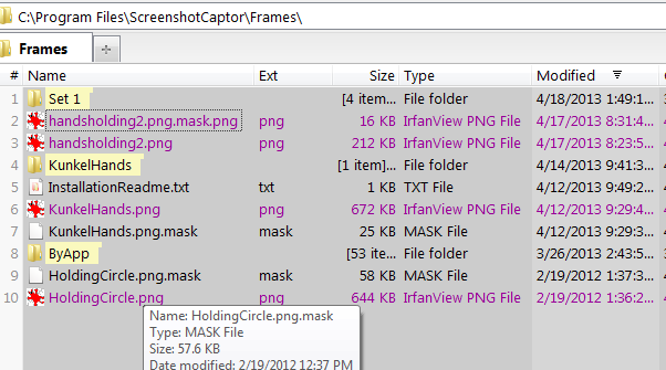

Using v 4030, putting "handsholding2.png" and "handsholding2.png.mask.png" in a subfolder of the frames folder does seemed to have worked.
Will try the next beta now...

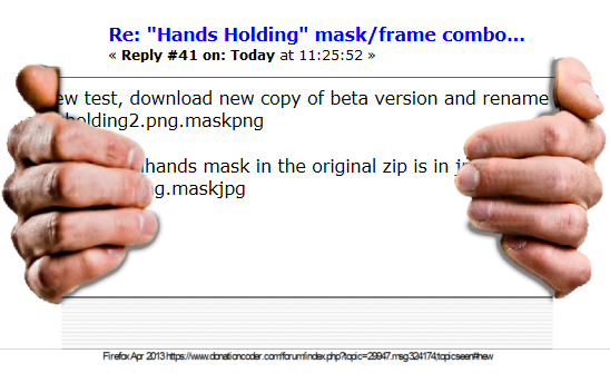

Quote from: kunkel321
(Dare I suggest that Crainioscopical share his balls?)
They're already in the air.
Here's my result with the latest beta...
[attachthumb]

Okay, also working fine here...  I downloaded the latest beta (also 4030) and got rid of the dot "maskpng."
Oddly, the older versions of the masks (kunkelhands and holdingcircle) have worked throughout all of the above tests--and still do work.   All three of the frame/mask combos pictured below are currently working; but notice that the naming conventions are different.
Weird -eh?
