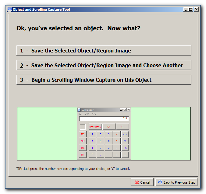

Re: Scrolling Capture Deluxe Thread
« Reply #63 on: January 25, 2012, 04:36 PM »
Ath, that is a good idea, but my first instinct is to minimize the options and features of that red box window that follows the cursor around, just because i worry about it being confusing.  Let's see if my new version is adequate.
New beta of Screenshot Captor is up that uses the new Scrolling Capture system:
http://www.donationcoder.com/Software/Mouser/screenshotcaptor/downloads/beta/ScreenshotCaptorSetup.exe
The new system is also used to capture "objects" even when you don't want to do scrolling.
In order to make workflow efficient, instead of the fun introductory dialog that was shown in the first scrolling capture implementation -- now you get the red box right away, and after you select an object you get a dialog.
One improvement in workflow is that it's now easier to understand how to do multiple OBJECT captures in a row -- useful if you want to grab various regions of a window -- and there is natural place for me to add features on window objects -- like adding an option to "capture all children windows", on the post-object-selection dialog.
Let me know what you think!
« Last Edit: January 25, 2012, 05:31 PM by mouser »
