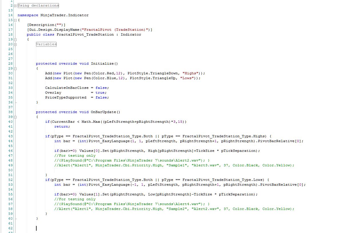

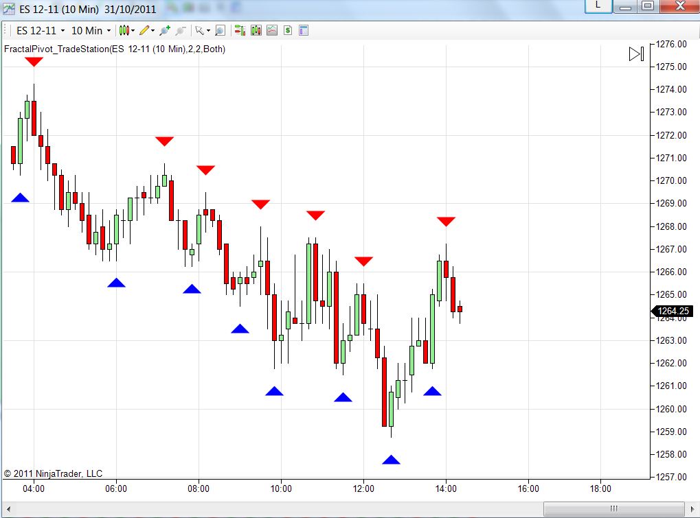

I have a "fractal indicator script" which provides Buy or Sell signals on Ninja Trader Platform. It shows visual arrows but does not give any audio alert. I want audio alerts when the visual arrows appear on the screen.
I have attached the script written in C#. I am not a programmer. I will much appreciate if some one can help.
Thanks

Sigh... Skimmed through it. I didn't see where any alerts are. (Skimmed quickly, so a closer look might help.)
If you can identify WHERE the notifications happen, it's simple to add an audio alert.
It might be that there is no way to do it in the code you've supplied. Check the program docs to see about customization possibilities.

My apologies. I had no intention of making you to read through so many codes of line.
Here are some details as I could assemble in few minutes.
The indicator script is designed to run on Ninja Trader ver 7. (www.ninjatrader.com). Once this script is run, it provides visual signals to buy or sell in market. Please see attached screen shot #01. You will find big red and green triangles there. I wanted to have audio alerts also along with these visual signs. So I added few lines of code reading from the help file of the software. These are shown on attached Screen shot #2 in green. They are showing in green because these did not work as required and they were commented out by me. When these lines were added, the audio alert happened on each tick and not when the visual triangle appeared on the screen. Please also note that there is a companion sub code file associated with this which is included in the zip file (also attached).IT contains all of code lines.
I am willing to show you live working on shared live screen sharing. I am in Toronto, Canada.
Thanks

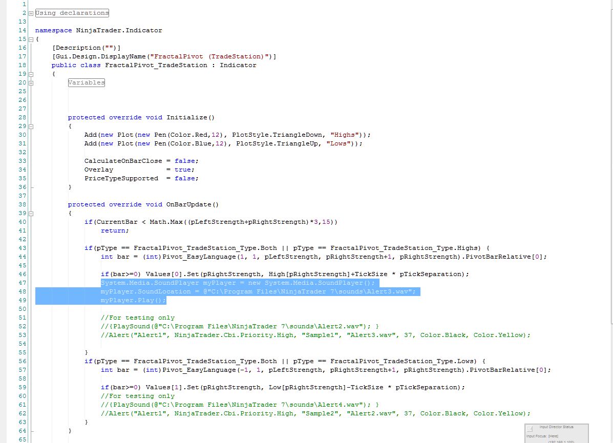

The second screenshot there has the sound code in it. Can you attach it here and post a link to the relevant documentation?
It looks like it may already have the necessary functionality in it, and that only needs to be enabled.
You can also try using this in the spot where you want to play the sound.
Code: (csharp)
System.Media.SoundPlayer myPlayer = new System.Media.SoundPlayer();
myPlayer.SoundLocation = @"c:\some-sound-file.wav";
myPlayer.Play();
However, make certain to replace "c:\some-sound-file.wav" with the proper path to the WAV file that you want to play. It MUST be a WAV file though. You cannot use MP3s or anything else.

Thanks for your quick reply.
I added the code lines. These are highlighted on the attached screenshot.
No sound.
The sound file used by me is good file because I can hear it when clicked directly.
Any help will be much appreciated.

                indicator.BarsRequired = BarsRequired;
                indicator.CalculateOnBarClose = CalculateOnBarClose;
#if NT7
                indicator.ForceMaximumBarsLookBack256 = ForceMaximumBarsLookBack256;
                indicator.MaximumBarsLookBack = MaximumBarsLookBack;
#endif
                indicator.Input = input;
                indicator.LeftStrength = leftStrength;
                indicator.RightStrength = rightStrength;
                indicator.Type = type;
                Indicators.Add(indicator);
                indicator.SetUp();
                FractalPivot_TradeStation[] tmp = new FractalPivot_TradeStation[cacheFractalPivot_TradeStation == null ? 1 : cacheFractalPivot_TradeStation.Length + 1];
                if (cacheFractalPivot_TradeStation != null)
                    cacheFractalPivot_TradeStation.CopyTo(tmp, 0);
                tmp[tmp.Length - 1] = indicator;
                cacheFractalPivot_TradeStation = tmp;
                return indicator;
// This namespace holds all market analyzer column definitions and is required. Do not change it.
namespace NinjaTrader.MarketAnalyzer
    public partial class Column : ColumnBase
        /// <summary>
        /// </summary>
        /// <returns></returns>
        [Gui.Design.WizardCondition("Indicator")]
        public Indicator.FractalPivot_TradeStation FractalPivot_TradeStation(int leftStrength, int rightStrength, FractalPivot_TradeStation_Type type)
            return _indicator.FractalPivot_TradeStation(Input, leftStrength, rightStrength, type);
        /// <summary>
        /// </summary>
        public Indicator.FractalPivot_TradeStation FractalPivot_TradeStation(Data.IDataSeries input, int leftStrength, int rightStrength, FractalPivot_TradeStation_Type type)
            return _indicator.FractalPivot_TradeStation(input, leftStrength, rightStrength, type);
// This namespace holds all strategies and is required. Do not change it.
namespace NinjaTrader.Strategy
    public partial class Strategy : StrategyBase
        /// <summary>
        /// </summary>
        /// <summary>
        /// </summary>
            if (InInitialize && input == null)
                throw new ArgumentException("You only can access an indicator with the default input/bar series from within the 'Initialize()' method");
#endregion
Re: Fractal Trading Indicator
« Reply #12 on: November 02, 2011, 10:28 PM »
Quote from: NinjaTrader Support
you can enable / disable specific sounds under Tools > Options > General  in your Control Center
-but maybe this option is missing if you are running the free version?
If you search their site and keep an eye on new feature development, you may want to look for "enhancement # 1254" (new audio settings).
