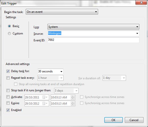

BTW, the trigger event required is: System->Winlogon->7002

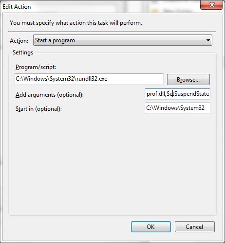

ADDENDUM: OK, took 5 minutes so I've got it working. :)
@TheArt: Sorry if I'm quick, I'm expecting pick up soon, someone might be able to fill in any blanks you have over the next 3-4 days.
Prerequisites: Password on the user account, you might also need the power button set to put the system to Sleep rather than Off.

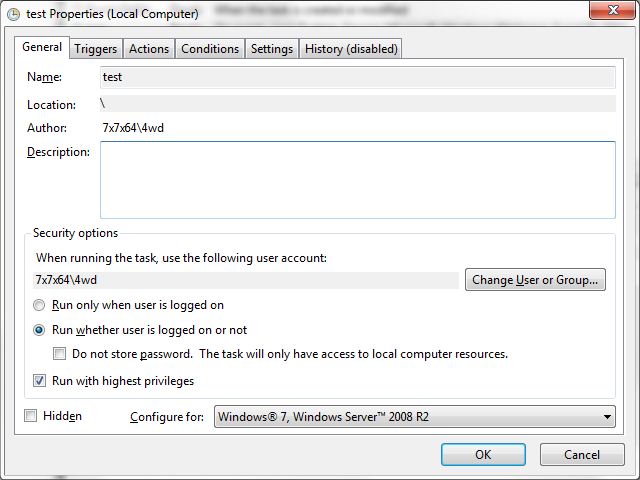

1) Open Task Scheduler and select Create Task (right side of window).
2) Give the task a name, set to run whether user is logged on or not, run with highest privileges - you'll need to enter your account password before leaving this page.
3) Edit the Trigger as follows:
4) Create an Action as follows:
The complete arguments line is: powrprof.dll,SetSuspendState

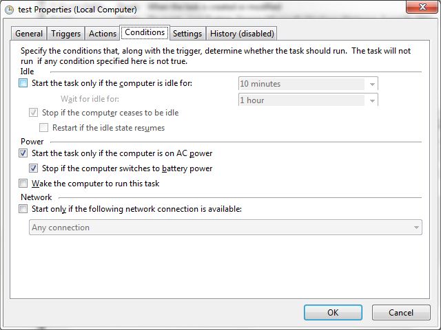

5) Set the Conditions as follows:
6) OK out of all the windows, you Task should now be listed in the Task Scheduler window.

BTW, if you don't want to have it do it all the time then under the Conditions tab you might try setting Computer Idle timeouts and to stop it if it ceases to be idle.

Re. the cancelling of the Task when someone logs on within the 30 second timeout, that's why I mentioned the following:
Set the Task to run after the computer had been idle for x and cancel it if someone causes activity, eg. logs on.  Setting an idle timeout here probably means you should remove the 30 second timeout under the Trigger tab.
