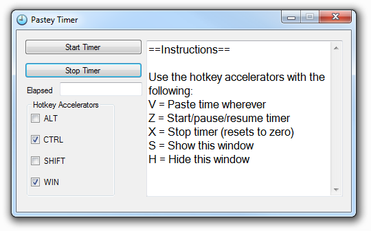

« Reply #2 on: October 04, 2011, 08:42 AM »
I am looking for a timer that is pausable. But also has a separate hotkey or button that pastes the current elapsed time (to the second) into an 'internal' or external text editor. After pasting it the focus moves to after the pasted time ready for me to type things. Would be great if it can also paste the current date but that is of course available in text editors so it's not very important.
If this makes sense (?) is it doable? or something like this exists already?
Thanks :)
See the attached file.
PasteyTimer.exe (165.5 KB)
Screenshot:
It doesn't do the date though.
Also, it's not polished.
* Currently the hotkey accelerator settings are not saved between runs.
* The clipboard is used as well, so when you paste, your clipboard has that data on it.
* It only shows hours, minutes, seconds. No attempt to do days, etc.
I've set it to be easy to use with your left hand. i.e. Use Z and X to start/stop. That way you can do it 1-handed. Sucks for lefties though...
It's .NET 4 Client Profile, so you need .NET 4 installed. (Sorry - had it finished before I realized that my defaults are for .NET 4, and not .NET 2.) Shouldn't be a problem though.
But, it does what you've asked for.

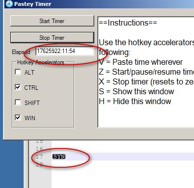

@Renegade, thank you very much :up: .NET is no problem. Running it and pasting into Notepad, works great.
Just a couple of things that are not a problem for me but just to look, the timer thing happened when I clicked stop twice in a row by mistake. The other is pasting into Notepad++ (language either php or normal text).

Yes - I was aware of the double-stop issue. It has to do with time calculations since Unix 0 time (I calculate time based on ticks). I didn't bother fixing it because I wanted to get it done quickly.
For Notepad++, offhand I don't know why that would be. However, I must admit that I did use the "cheap" method of sending text to the 3rd party application. Again, that was in the interests of time. Doing it "right" would take me a day or so. I only tested in Skype and Editplus, and they worked fine. I never tested in Notepad++ or any other applications. :(
(Having looked into the problem further, the solution seems to be to use the native method keybd_event in user32.dll to send data. A bit more to it than that, but... that goes from 1 line of code to 1,000 lines of code...)
To get around the Notepad++ problem, you can focus on anything that doesn't accept text input, press hotkey + V, then in Notepad++ do a normal paste. That relates to the lack of "polish" I posted above where the clipboard is used and the data remains on the clipboard.
