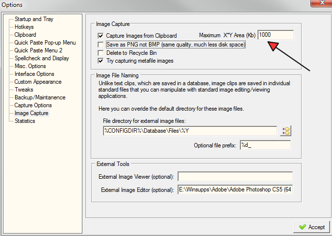

Re: CHS: New Formatting Dialog
« Reply #53 on: October 27, 2011, 01:24 AM »
Is it this?
[attachthumb]
« Reply #54 on: October 27, 2011, 02:27 AM »
@cranioscopical: Thanks for pointing that out. Actually, I'm not sure what that is.
My settings say "Max X*Y area (Kb) 1000" - I presume that relates to Kb of data, but I am not certain.
I guess I need to understand what it is first.
One of the smaller images that CHS stored in its database was a .JPG file of size 41.9kB, and 900x750 pixels on display.
One of the larger images that CHS did not store in its database was a .PNG file size of 172.4kB, and 1349x1766 pixels on display.
« Reply #56 on: October 27, 2011, 02:58 PM »
The way to read that threshold number in the options is to multiply the new candidate image width*height, then divide by 1000.
If the value you get for your new image is larger than that number, it will be rejected.
For your sample image that was rejected your image was:  (1349*1766)/1000 = 2382.334
So the default options value of 1000 would have rejected it.
If you want to copy every image just set that value to something like 99999.
« Reply #57 on: October 27, 2011, 04:34 PM »
Thanks for the solution.
I just reached that empirically and returned here only to find your response. Last past the post, as ever  ;D

« Reply #58 on: October 27, 2011, 08:32 PM »
+1 for what @cranioscopical said. Many thanks for the explanation of that. Sorry if I had missed it elsewhere.    :-[

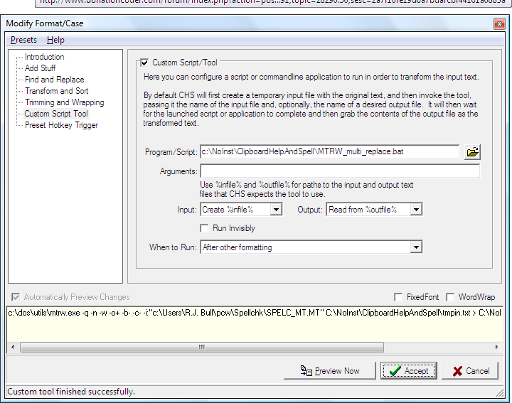

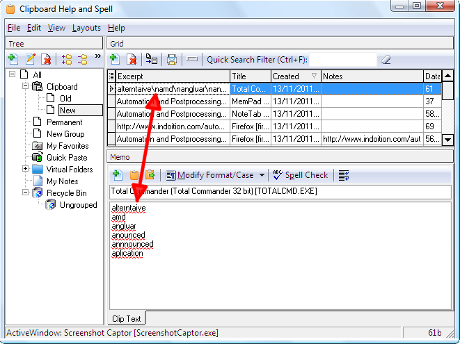

Just been trying to put Jason Hood's version of "Ministry of Truth," a multiple search-and-replace utility, as a user tool into the Presets.  I'm getting an error message from it:
mtr: \N is not a valid escape sequence in C:\NoInst\ClipboardHelpAndSpell\tmpin.txt
When I look at the (test) input text in CHS's grid, it looks like the first screenshot below.
Where are the "\n" coming from?  Is that what's causing a problem?

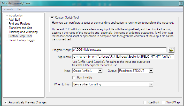

« Reply #61 on: November 14, 2011, 09:11 PM »
I'm fairly sure it's mad about the commandline invocation with the %infile% name having spaces in it and not being double quoted.
Still didn't work.  Essentially the same command line does work as a Text Filter in TED Notepad, using its %~S parameter for marked text, so either I haven't understood CHS's parameters correctly, or there's a significant difference in how the two programs handle STDIN/STDOUT, or both.  I found I could make it work by a minor cheat; wrapping the utility in a batch file.  The batch file is:
c:\dos\utils\mtrw.exe -q -n -w -o+ -b- -c- -i:"c:\Users\R.J. Bull\pcw\Spellchk\SPELC_MT.MT" C:\NoInst\ClipboardHelpAndSpell\tmpin.txt > C:\NoInst\ClipboardHelpAndSpell\tmpout.txt
and the matching CHS Preset configuration is as in the screenshot.
How does one delete a user-entered Preset, please?
I should add: you give four slots for search-and-replace pairs in CHS's standard presets, which is generous; that's the same as the payware version of Boxer Software's Text Monkey.  The advantage of using MiniTrue is that it's a freeware that gives you an essentially unlimited number of pairs, especially now it's available in Windows 32-bit form.  It's still a rather strange program, though.
« Reply #62 on: November 14, 2011, 09:23 PM »
this would be my first guess.
could you do this: take the commandline that CHS would run, and run that manully under a dos window.  does it produce the right output?
and when you try to run it from CHS, what error does it give you?
« Reply #63 on: November 18, 2011, 08:53 PM »
Here's what I did, but it's getting my head in a spin.  Both these command lines - minor variations - work properly in a console window:
Code
c:\DOS\Utils\mtrw.exe -q -n -w -o+ -b- -c- -i:SPELC_MT.MT test.txt > mod.txt
type test.txt | c:\DOS\Utils\mtrw.exe -q -n -w -o+ -b- -c- -i:SPELC_MT.MT >
mod.txt
So far, the batch file method in the earlier message seems to work perfectly.  It's the only one that does.  I also tried the following, to the point where I lost track of what I was doing:
Using MT to change the file in-place:
Program/Script: c:\DOS\Utils\mtrw.exe
Arguments: -q -n -w -b- -c- -i:"c:\Users\R.J.
Bull\pcw\Spellchk\SPELC_MT.MT""%infile%"
Input: Create %inifile%
Output: Read from %inifile%
Returned:
Error RE-reading input file C:\NoInst\ClipboardHelpAndSpell\tmpin.txt (for tool
output, see tool config) -- nothing changed in file --  after tool run:
c:\DOS\Utils\mtrw.exe with params -q -n -w -b- -c- -i:"c:\Users\R.J.
Bull\pcw\Spellchk\SPELC_MT.MT""C:\NoInst\ClipboardHelpAndSpell\tmpin.txt"
Using MT to change the file in-place, ignore outfile:
Output: Ignore
Returned:
CHS reported Custom tool finished successfully, but it didn't do anything (no
changes)
Using redirection to make a new file:
Arguments: -q -n -w -o+ -b- -c- -i:"c:\Users\R.J. Bull\pcw\Spellchk\SPELC_MT.MT"
"%inifile%" > "%outfile%"
Output: Read from %outfile%
Returned:
Error reading output file C:\NoInst\ClipboardHelpAndSpell\tmpout.txt after tool run:
c:\DOS\Utils\mtrw.exe with params -q -n -w -o+ -b- -c- -i:"c:\Users\R.J.
Bull\pcw\Spellchk\SPELC_MT.MT" "%inifile%" >
"C:\NoInst\ClipboardHelpAndSpell\tmpout.txt"
As above but with redirection symbol wrapped in quotes, ">"
Returned:
Bull\pcw\Spellchk\SPELC_MT.MT" "%inifile%" ">"
Reading from STDOUT;
"%inifile%"
Output: Read from STDOUT
Returned:
ERROR: Previously launched tool is still running. Close that process before
continuing.
Had to kill process.  Later found an open and empty console window.
Send on STDIN, Read from STDOUT
Input: Send on STDIN
Returned:
changes)
Repeat: the batch file method worked OK.  What have I missed?
« Reply #64 on: November 18, 2011, 09:03 PM »
Using MT to change the file in-place..:
for this you should have told CHS to read output from input file.  that should work.
as for the failure to read from stdout -- i suspect the cause is chs failing to read stdout properly, i will look into it.
  • Posts: 3,217
« Reply #65 on: November 18, 2011, 09:28 PM »
I thought I had, but, I was getting in a tangle.  Look at the one that starts "Reading from STDOUT;".  That's the one where I had to kill the process.

In order to test it, I tried a few words from that file.  Hence test.txt:
tje wolrdwide catridge
If you open a CMD.EXE console and run this line:
you don't see anything on screen - you aren't supposed to - but you find a new file mod.txt that contains
the worldwide cartridge
which is the correct transformation.
type test.txt | c:\DOS\Utils\mtrw.exe -q -n -w -o+ -b- -c- -i:SPELC_MT.MT > mod.txt
also works, as does
c:\DOS\Utils\mtrw.exe -q -n -w -o+ -b- -c- -i:SPELC_MT.MT < test.txt > mod.txt
Is that enough explanation?  I can't immediately think of anything else to add.
