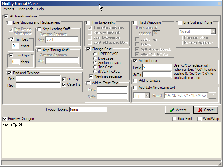

I have concluded that it would be best to reorganize the modify/formatting dialog, to move from an all-on-one-page view, to a tabbed view.
Old dialog:

I think you need something in the middle. The new design has too many tabs, but the old design doesn't have enough. Maybe create just three tabs where related items are grouped together.
This also brings up another issue. If the changes you want to make require operations on two different tabs, does that now mean you have define (and execute) two separate PreFormat definitions to get all these changes?

Yeah i can combine some of the sparse tabs.
A saved preset saves/applies ALL formatting on all tabs.
I have an operational question. How can you make creating/using presets intuitive if saving a preset means saving across multiple tabs? In my mind, this design is counter intuitive. (I wonder if Steve Jobs would approve?)
Maybe you could group all the formatting operations that are commonly done together on a single tab. If that's done, then this issue is moot. This also means minimizing the number of tabs in the UI design.

I can see your reasoning but I have to agree that the new layout that you showed above seems counter-intuitive. On the existing panel, I can use your cleverness to create some useful items in a trice (only a little slower than a bice but certainly faster than a vice). By the time I stumbled through the new layout I'd have forgotten what I was trying to do. I have found it useful to see all of the options in one place. Keeping together as many items as possible would be an advantage, as seen from my purely selfish perspective.

i can try to combine more per page.  as you can see from my first post i am inclined to agree that the new tabbed method is going to make it somewhat more cumbersome to do quick stuff.  it just wasn't sustainable -- i was quickly running out of space and adding things became a question of where to put it..  the new approach removes that constraint which is the important thing.
so i don't think there is any going back from this new tabbed approach -- but i can try to reduce the number of tabs.

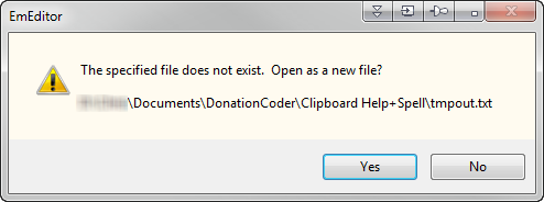

chs_sampletool.exe wants a .dll that I don't appear to have. The Perl script does its best but is thwarted by the fact that I haven't Perl installed  :)
As far as I can see, though, the mechanisms work as intended — FWTW. Items set that don't call those tools work fine, as with the old, single panel.
It must be my setup. I just set the external tool to be an editor and the editor is looking in the wrong place for the file.

  • 1. I'm repackaging with a sample tool that doesn't need visual studio runtime dlls, so that should solve that problem.
  • 2. As you noted, the perl sample tool will only run if you have perl installed and configured on your pc; that is as designed.  One could build the perl sample into an exe but the point was simply to let you test running a perl script directly IFF you have perl installed.
  • 3. As for using an editor.. it's failing because you are passing in both the input and the output file, and the output file doesn't exist yet.  However, i will modify the way tools work so that you can actually use it with a tool that reads and writes to the same temp file, the way an editor would.  That will let you use it in the way you are trying.

I've uploaded a new version that will also work with tools that write out the changes to the input file.
You can test this by downloading new version and then setting the tool to: notepad.exe
But if you do, make sure you change the argument string to just "%infile%" (instead of "%infile%" "%outfile%").
Re: CHS: New Formatting Dialog
« Reply #20 on: October 10, 2011, 10:39 PM »
I've uploaded a new version that will also work with tools that write out the changes to the input file  ... make sure you change the argument string to just "%infile%" (instead of "%infile%" "%outfile%").
That works very nicely and hands stuff out for processing by an editor that has many years' worth of Rexx macros built into it.
