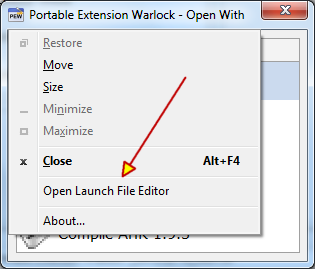

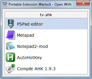

Just chiming in to say that PEW is an awesome upgrade to ChoiceEditor which I was using previously. :up:
"Open With" window showing alternate launchers for the extension "ahk"
ProTip: you can access the "configuration editor" via the system menu of the "Open With" window.

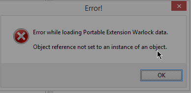

Hi hamradio.
Long time donationcoder reader. Somehow missed your app. I have been looking for something similar for AGES.
I am having a lot of problems even just settings thing up.
On launch of PortableExtensionWarlock.exe
I get the following error:
Error!
Error while loading Portable Extension Warlock data.
Object reference not set to an instance of an object.
OK
I click OK and go into the app.
i try to add an entry and get this error
Index and length must refer to a location within the string.
Parameter name: length
OK
Please help! I really, really want to get PEW working :(

Bug #1:
1. Open clean (virgin) copy of PEW
2. Immediately click top left button for "Save the launch file" (with no entries).  [[Note: PEW saves launch file]]
3. Close PEW
4. Open PEW
5. Observe error (see pic)
