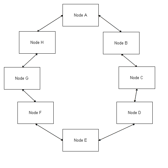

Approach
I have set up each machine in our cluster to monitor two others. I've found this to be the optimal arrangement. If we lose a node, we get a maximum of two other servers alerting us to the fact. Even multiple node failures will always ensure a manageable quantity of alert messages instead of being swamped.
So what happens is that every minute, each machine asks its partner machines their status. This is achieved by a small self-written program installed as a Windows service. Every 60 seconds it wakes up and executes a simple call to each web service that it knows about. Depending on the result of this call, the software performs various logging operations and takes further actions if required.
In my case, our webservices will respond to the equivalent of a ping request, returning a brief status message.

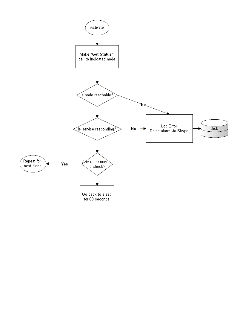

One of three things can happen:
- no response: panic in the streets!
- bad response: check as soon as possible
- good response: back to sipping coffee
This diagram exemplifies the steps taken.
I decided to keep it very simple: if we bump into an issue, the event is logged so we can trace back when things began to go wrong. But also, if there is an important state change, several of us on the support team are instantly notified by a Skype instant message right to our desktops. Our monitoring app can also dial out via Skype to whoever is on call.

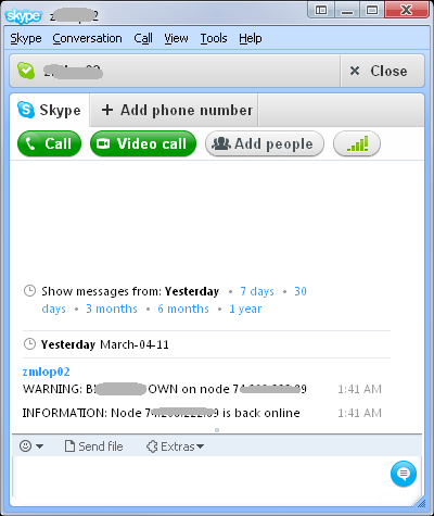

As you can see, what's really nice is that I can now write entries into any server's log file from my desktop, simply by sending an IM from my skype account to the destination server! We use this facility to annotate various activities and it provides a useful audit trail.
Sample from our log file:
Code: (generic)
9/25/2010 1:36:22 PM-I-Sent Timxxxxx: WARNING: Bxxxxx DOWN on node xxx.xxx.xxx.xxx
9/25/2010 1:36:22 PM-I-Recv Timxxxxx: Ok, I got this one
9/25/2010 1:36:25 PM-I-Sent Txxxxx: INFORMATION: Bxxxxx UP on node xxx.xxx.xxx.xxx
9/25/2010 1:36:27 PM-I-Recv Timxxxxx: Ping timeout. I blame the ISP ;)
