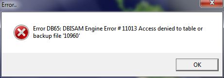

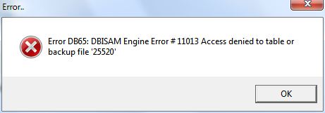

and upon starting it up was promptly presented with

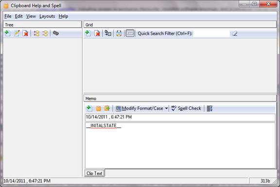

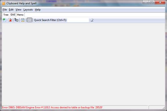

clicking OK dismissed it. I get the same error EVERY time I left-click on the tray icon. Bringing up the main window give me a bad looking one

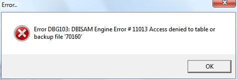

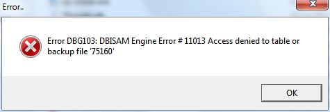

so I closed down CH+S. Upon restarting the program I am presented with
and clicking OK dismissed it. Again, every time I left-click the tray icon I get

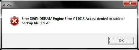

deepskytraveler
  • Posts: 23
Re: Error EX4: DBISAM Engine Error #11013
« Reply #59 on: October 14, 2011, 10:27 PM »

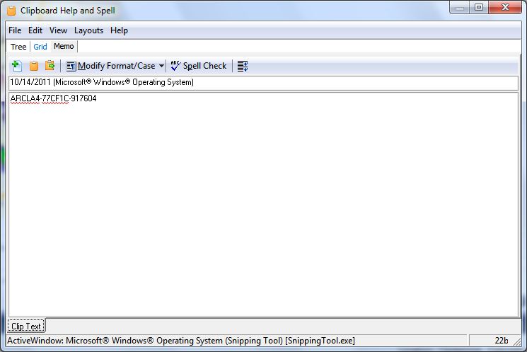

Uninstalled and deleted the old database. Installed the latest alpha,  2.09.02, and getting the same errors as spknapp.
On startup....
After a ctrl-c...
The errors dismiss and CHS continues to run. The grid doesn't look as I expect it to look and none of the grid presets are showing in the pulldown....

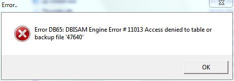

« Reply #60 on: October 14, 2011, 10:36 PM »

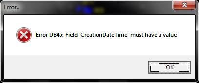

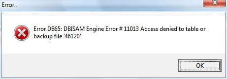

Switched back to database temp directory as you suggested. CHS started up without error. First clip okay. Grid looks as expected. Moved clip between folders. No problems. On second clip however got this error...
Dismissed this error and took another clip - successfully.  Go figure.
Mark

It's hard to know if those "CreationDateTime" must have a value errors are related to the previous 11013 error -- that's why i'm ignoring them until we get the main bug fixed.
Let me know if you see any other errors now that the temp directory is changed.

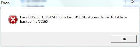

spknapp
  • Posts: 14
« Reply #63 on: October 14, 2011, 11:09 PM »

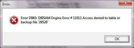

Nope. Still no good, no matter what I set the temp file tweak setting to.
Bringing CH+S up the first time after the new install it throws
and throws this every time I left-click the tray icon, too.
Shutdown and restart CH+S gives me this upon starting
and every time I left-click the tray icon.

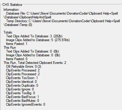

Error or not, paste me another screenshot of your stats with the new version.

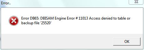

spknapp
  • Posts: 14
« Reply #67 on: October 15, 2011, 03:13 AM »
I uninstalled the version that works good, and installed your latest version. Immediately on startup it threw
I clicked OK and it went away. I then went into options to change the tweak Temp Directory setting and when I clicked "Accept" I got
followed by
Left-clicking on the tray icon gives me
every time I left-click on the icon. When I open the main window it looks wrong
I have exited and restarted CH+S with the same reults.
This is the same thing that has happened the last three times I have tried your "latest" versions.

can you screenshot me the Statistics tab?

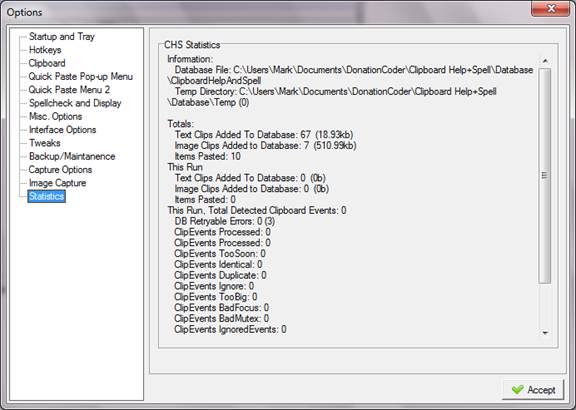

deepskytraveler
  • Posts: 23
« Reply #69 on: October 15, 2011, 06:03 AM »

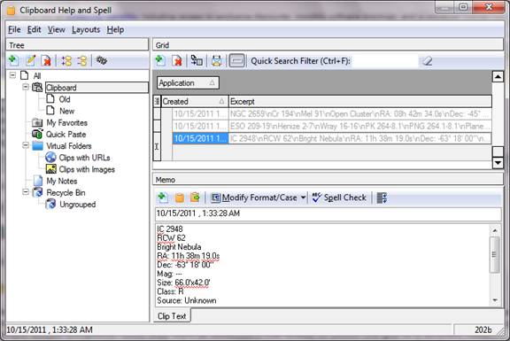

Downloaded the latest alpha version per your 6:20PM post.  Just ran through a quick sequence of capturing clips. No problems. Dragged and dropped clips between folders in the tree. No problems at first. However after clicking around a half dozen or so times on different folders in the tree I began getting multiple access exceptions. Once they were all dismissed I was unable to switch to a different folder. Exited and restarted CHS. Was able to recreate the same problem. Exited and restarted CHS again. This time the grid window looked like this...
Just had to try it one more time...restarted CHS the grid window looked as I expected it to...
Here's my stats page...
Going to call it a night. Will be out of pocket until Saturday afternoon. But will be glad to continue to test.

Good news! Looking good!! Just went through my series of test cases. No errors. No unexpected behavior. Will continue to exercise it over the weekend and report back. Hope it works as well for spknapp.  Here's my stats page...

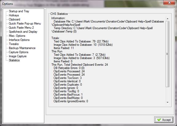

spknapp
  • Posts: 14
« Reply #73 on: October 16, 2011, 05:18 AM »
Looking good!! It starts up without any complaints; I can backup/restore/verify the database without any errors; and I have clipped and pasted several text and graphics all without incident! Here's my latest statistics (notice the default temp location!):
I'll keep playing but it looks the best so far! Thanks!
