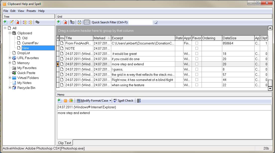

Hi mouser,
thanks a lot for adding the stack feature to CHS. I finally started using it in some real live scenarios and found it extremely time-saving. I can only recommend to everybody to check it out as soon as you have to transfer a number of strings from one location to another (e.g. when filling a form, doing a series of file activities or dealing with callouts in screenshots). Also, having these functions available via shortcuts is excellent.
If time permits (some day... ;)), it would be great if you could do one more step and extend, I guess, the grid in a way that reflects the stack mode and status. Right now, it has somewhat of a blind flight when I use the feature. I know there is the pop-up from the tray, and I can't really tell why, but I think the use would be much more intuitive if the users could see in the grid where the stack pointer currently is, and which way it will go. Maybe it just needs a sort of special icon in the first column of the grid (which probably should appear in the Clipboard > New  subtree only to work in a safe way, but that might be sufficient) – would this be much effort?

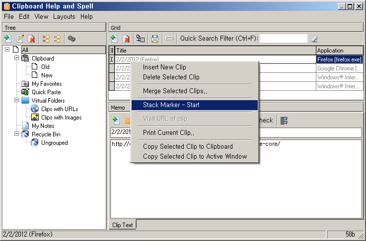

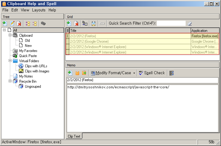

Here is one flow that seemed to work here for a manual sequence (Windows 7 Pro 64-bit):
1. Populate CHS with clips (e.g. copy clips while CHS is monitoring clipboard) and verify via CHS Main Window
(can be done via tray menu or hotkey [default Ctrl+Alt+w]):
2. To specify the top of the stack, right-click on a clip and choose "Stack Marker - Start":
3. Bring focus to target paste area and use hotkey (default Ctrl+Alt+V) to paste.
4. Repeat previous step as necessary.
There may be other ways to do things too -- e.g. there appears to be a "Set stack start marker" in CHS' tray menu and there appears to be a way to assign a hotkey to "Stack Marker Start" in the Hotkeys area of the Options dialog.
I didn't figure out how to get pasting-in-sequence to occur automatically.

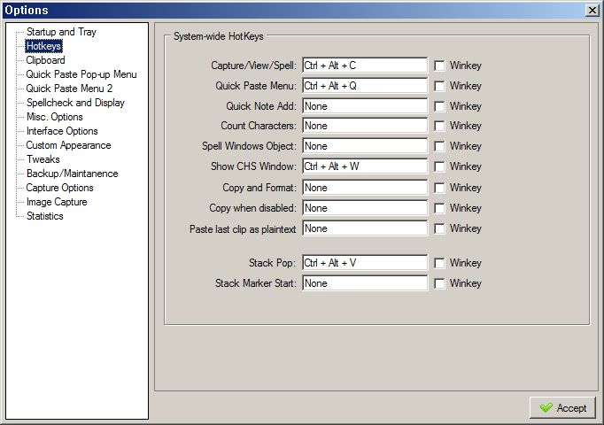

ewemoa - I'd love to try that.  But Ctl-Alt-V does nothing for me. Which hotkey is it?  I don't see it.  There is a paste last clip as plaintext. That's not working for me either.
ewemoa
  • Posts: 2,922
Re: Auto-push/pull clipboarder?
« Reply #16 on: February 02, 2012, 06:44 AM »
Here's what I see in the options dialog in the hotkeys section (Stack Pop):
What do you see in yours?
futurevision
  • Posts: 3
« Reply #17 on: February 02, 2012, 06:58 AM »
Ah, the Pop, yes.  That works.  Nice.  Thank you!  I appreciate your time and help.  I thought I had tried that but obviously didn't do it exactly right.
