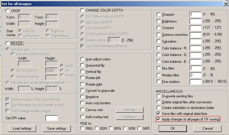

I was looking at the "Set for all images" dialog (what comes up after pressing the Advanced button), and I noticed a check box with the label "Apply changes to all pages (if TIF saving)".
Does that not help in this situation?

I've had a good go with Irfanview and was amazed, given the millions of options and buttons, that it won't do what I want.

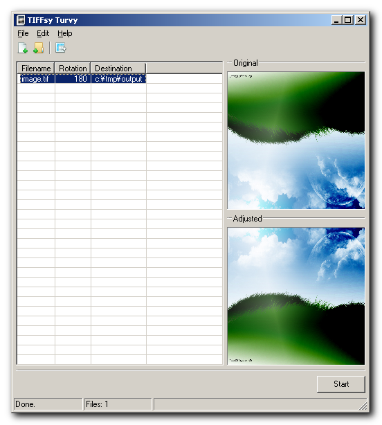

Here's where I am now...

Thanks skwire, that's looking neat.  I have forwarded the email i get when i receive a fax.  Funnily enough i managed to fax it the right way around the first time, so i had to refax it again to get it wrong :)
